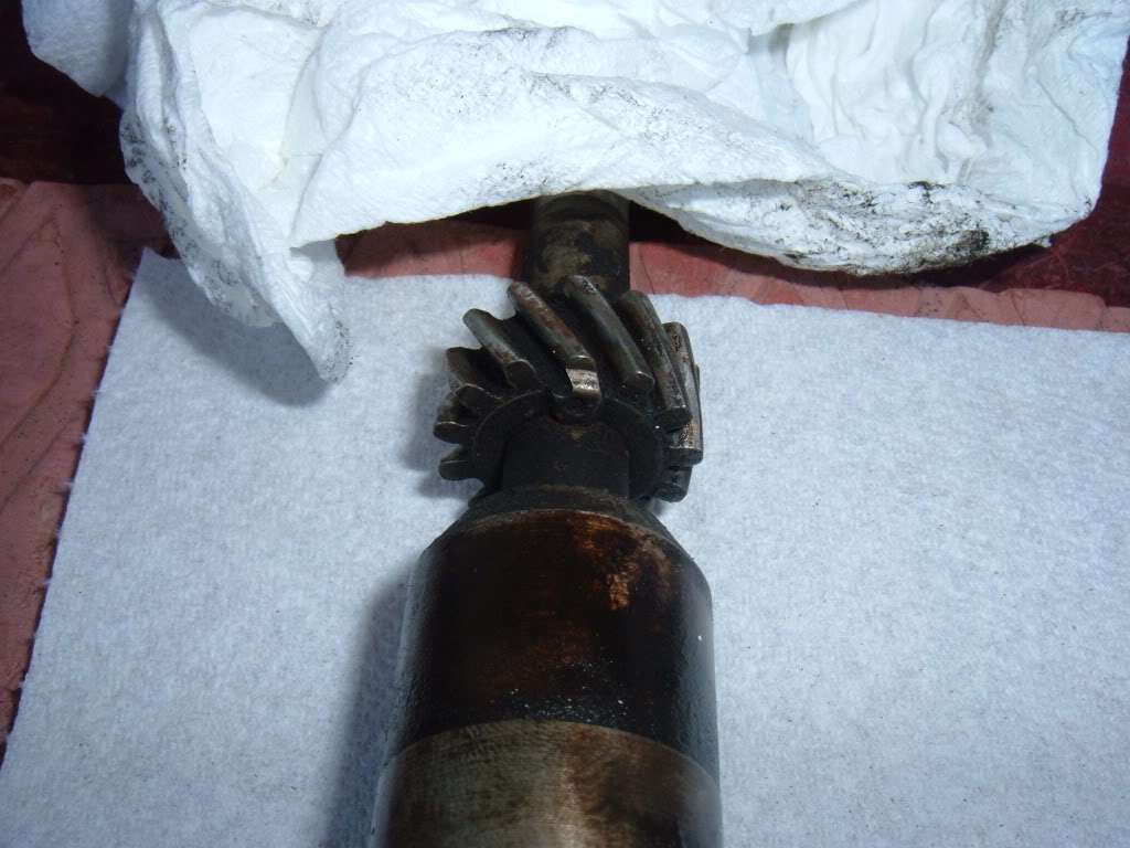

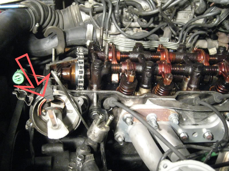

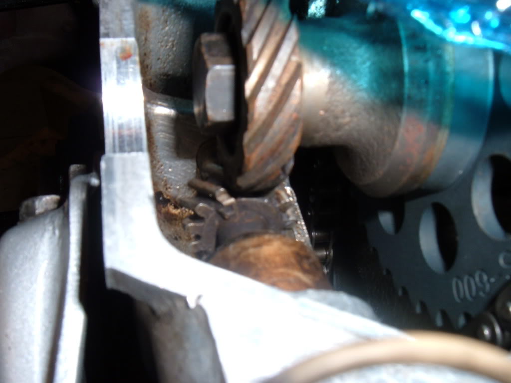

Dimple on top of the dizzy drive gear goes just b4/counter clockwise of the CAM-dizzy drive gear.

Everything sounds NICE, CONGRATZ, PHIL!
I turned the motor over w/out coil a few revolutions and then slapped it on for cam break in. U go with the 261?

Thanks Chef - I thought so, on the distributor gear, from when I did it before..is that at TDC or 5* BTDC that you set it JUST in front like you mention?
