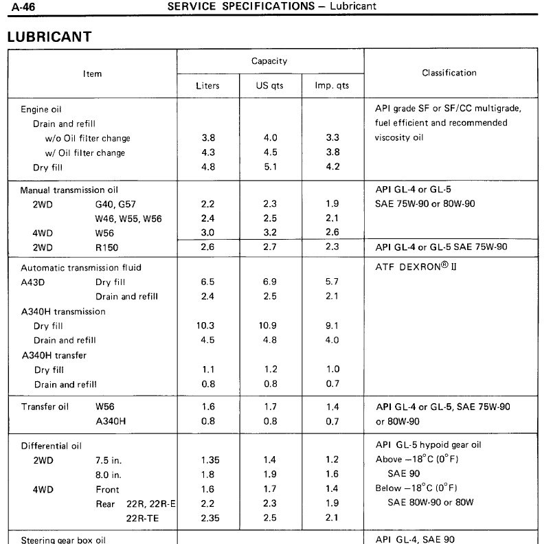

Ok. I know there’s plenty of info on this except that I have drained and filled my manual tranny with specified amount and is still not flowing out of fill hole. This is not my first manual tranny change. Manual says 2.4 qts. I put 3 full quarts of Amsoil manual tranny lube without getting to flow out. Should I keep filling? Shifting is a bit knotchy after change so I feel that it’s not at the proper level. Any risk of overfilling? How could this be so far off? I now have to order more Amsoil which won’t be here for three days and want to make sure before I order and don’t want to mix with the cheap autozone tranny fluid. Also my Haines manual calls for 3.2 quarts in the transfer case which doesn’t even take 1.5. Not sure what there thinking is here. That would be one huge transfer case.

RAD4Runner's Avatar
Join Date: Mar 2012
Posts: 7,090
Received 670 Likes on 459 Posts
Escalade-year-engine-transmission-2WD/4WD-trim please?
From 1988 22RE FSM ....
Attached Thumbnails Manual tranny fill level?-screen-shot-2018-01-12-10.52.41-pm.png
