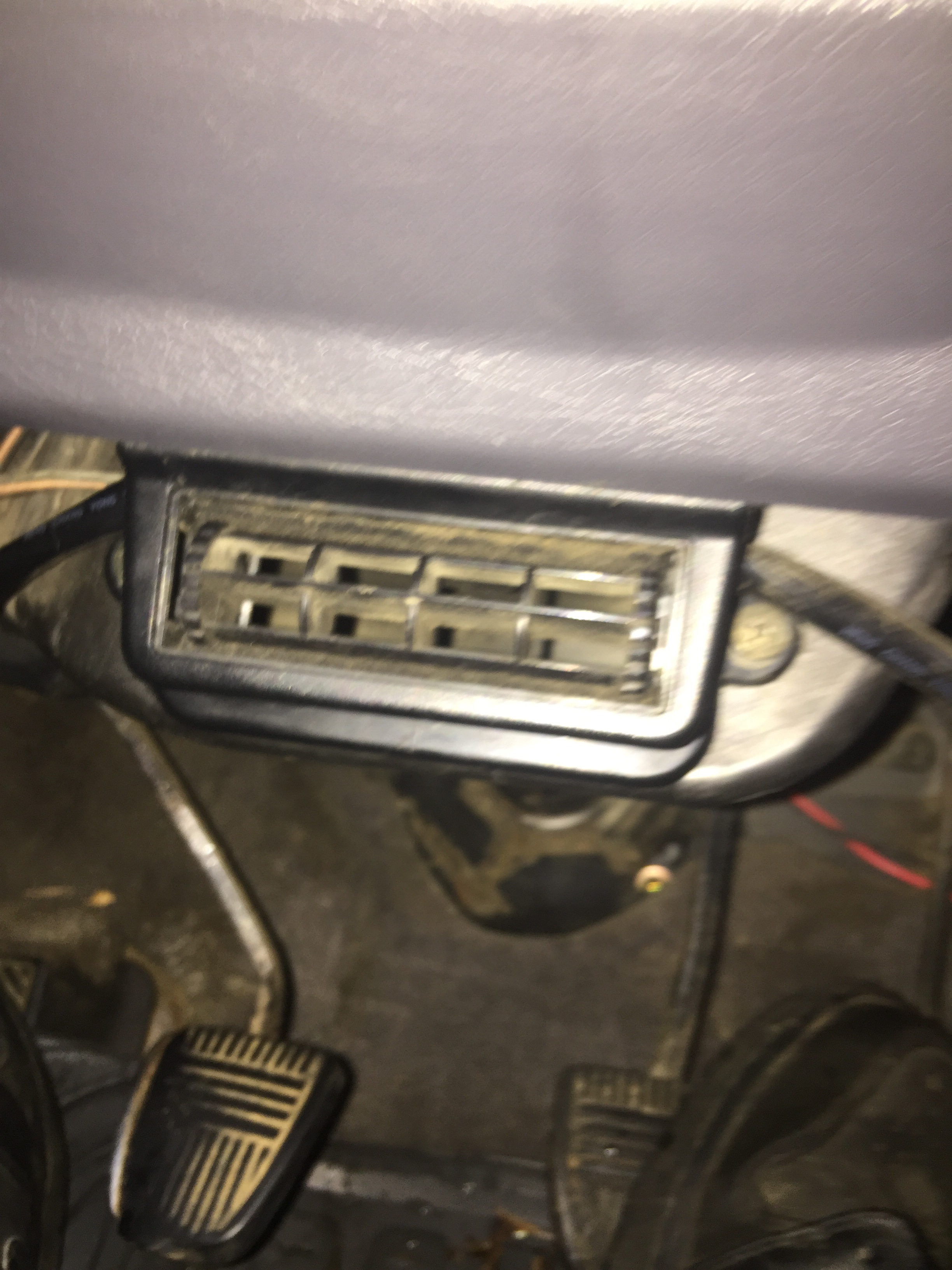

So say I left my heater on when I turned the car off and then it dumps like crazy I come in and it's dripping from around the floor heater Looking for a water leak-photo835.jpg
This is the passenger side that it was dripping from from under the glove box and then on the drivers side on top of the little floor heaterLooking for a water leak-photo732.jpg

What about your heater core? That is my suspect.

I'll have to check it so I closed my vent to circulate air in the cab and non fresh air it's raining a bunch right now I'll check it in a little bit see if it's still dripping and the more tear down will happen

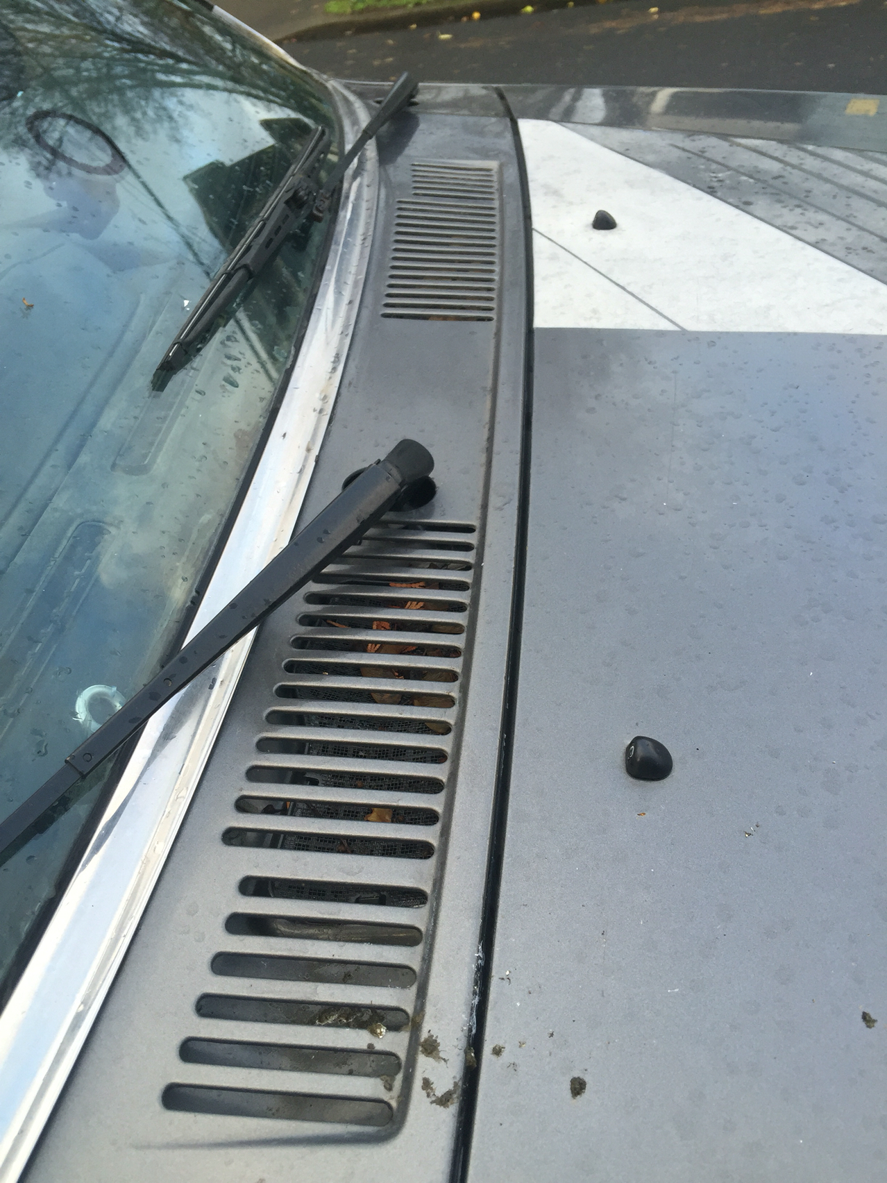

Maybe your cowl drain is clogged and water is pooling there and when vent is in fresh air mode, it sucks some of that water in?
Cowl screen design is flawed. It allows leaves, etc. in only to be trapped in the drain that is too small.

Yes that is kinda what I was thinking I'm gonna take it out and try and use a shop vac go try n get it all out

heck behind your mudflaps and see if you have debris there. That could be a sign of a clogged cowl and drain vents.
