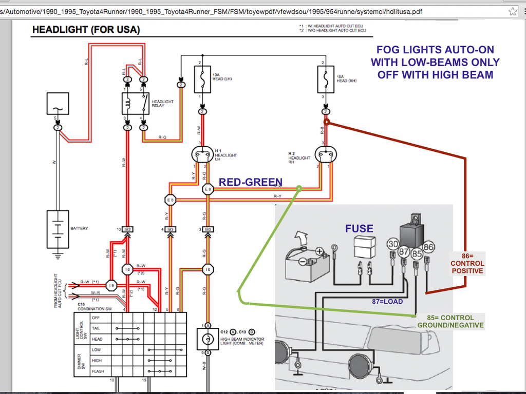

1994 model trucks and 4Runners may still have switched ground control for headlights. If that is so, merely tapping positive of relay coil to positive side of low-beam beam wire and grounding the other side of relay coil will not work.
To simplify your wiring BUT STILL MAKE IT WORK LIKE YOU ORIGINALLY WANT:
(1) Tap positive side of relay coil to positive side of low-beam filament, and
(2) Tap negative side of relay coil negative side of low-beam filament
Do this very close to the bulb connector to be exactly sure of the wires.
However, best if you posted (1) schematic of your truck, and (2) schematic of your fog light kit so we can pinpoint exactly where to tap off of.

OK, found schematic for 1990-1995 4Runner. Should be the same.
Here's your circuit:
Before you do anything, probe pins 2 and 3 make sure there is 12V across them when, and only when, low-beams are on.
You can disconnect connector from bulb in order to prove for voltage. positive (red) probe on 3, negative (black) probe on 2

No dice. But my wires are the same colors as in the schematic you provided. I hooked up the relay and everything like your image indicated. Here's what happens; The fog lights come on with my headlights and turn off with my headlights, but they stay on during low beam and high beam.
I think I noticed something; Once I turn on my head lamps the low beams seem to stay on even while the high beams are switched on. And one of the wires always seems to be energized. I'm guessing that's the red/black.
Perhaps if I just connected 86 to red/green and 85 to red/black? Would that yield the results I want? I don't know. I'm just playing with wires here.
