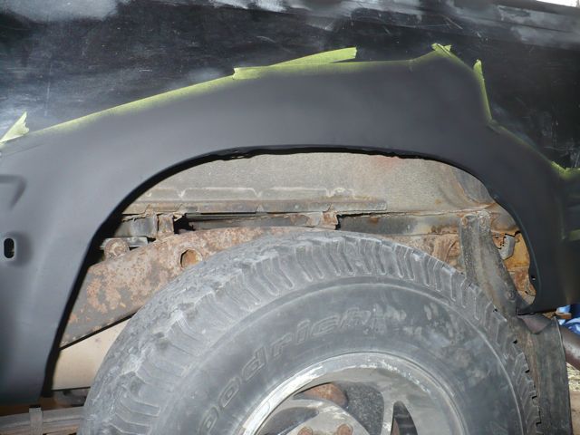

I recently have undergone some body work on my '95 pickup (bed wheel arches, cab corners, doors) so I thought I'd share my perspective. Though bondo is quick and dirty I don't believe it's meant to fill rust holes. I chose to cut out the rusty section with a cut off wheel on the grinder and patch weld in new 22 gauge metal, welded solid. I then ground down the welds and skim coated some bondo so it looks more pretty and primed and will paint. I also painted and sprayed rubberized undercoating on the back side of the bed. If I have to do it again though I probably would buy some wheel arch replacement pieces and weld those in versus trying to form my own with little metal working tools. Good luck!, fiberglass would be cool too but metal is cheap and if you have a welder......
Attached Thumbnails How to deal with rust above wheel wells?-p1030552.jpg   How to deal with rust above wheel wells?-new.jpg
