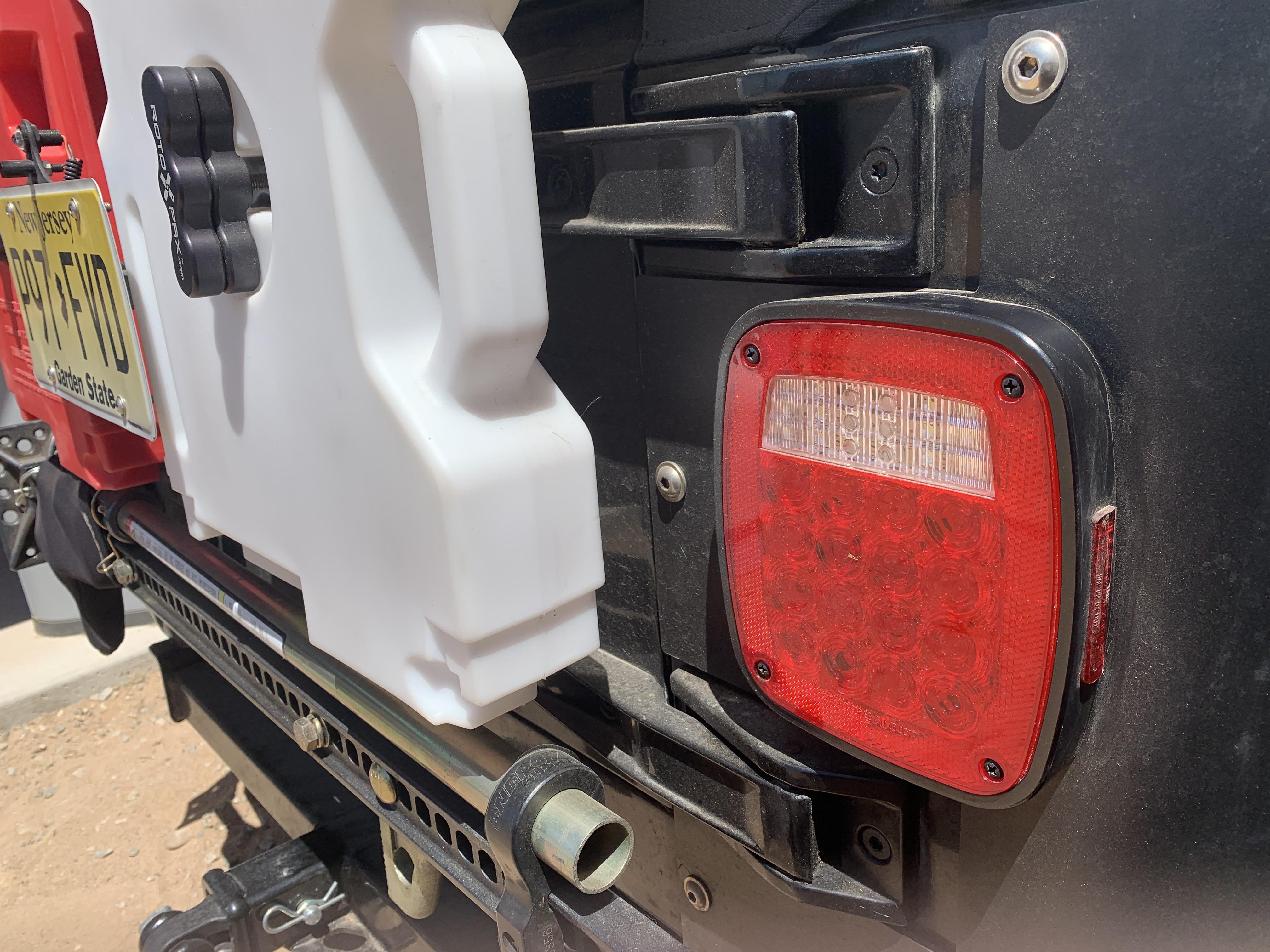

last tip, you can use regular bolts and washers but if you go to https://www.aa-mfg.com and search for body washer and pick up a few different sizes or the kit they sell, they make for a much cleaner finished look.
here is how I used them on the inside of the bed rail to mount the bed sides
