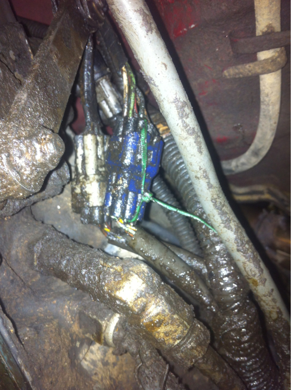

This happened to me to,
On my 4 runner, it was a plug that is on the passenger side of the trans, the little plastic lock on the plug broke off and it disconnected itself, I plugged it back in and used a zip tie to hold it together.
^Thats what i'm leaning towards. Or you have a stripped out auto hub. If so ditch them suckers and get some manual locking ones. Not warn, not superwinch. Best bet would be a junk yard or someone online who has an AISIN Set. Good luck on your hunt for 4 wheel drive!!!
