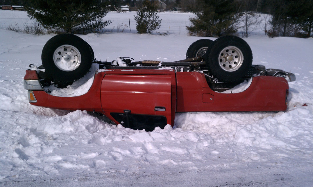

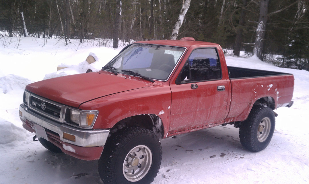

I hit some ice today and my truck flipped onto the roof. No injuries - not even broken glass. I guess three feet of snow is good for something. I have the truck back home in the driveway. Since it was upside down for about 2 hours, what do I need to do before trying to fire it up?

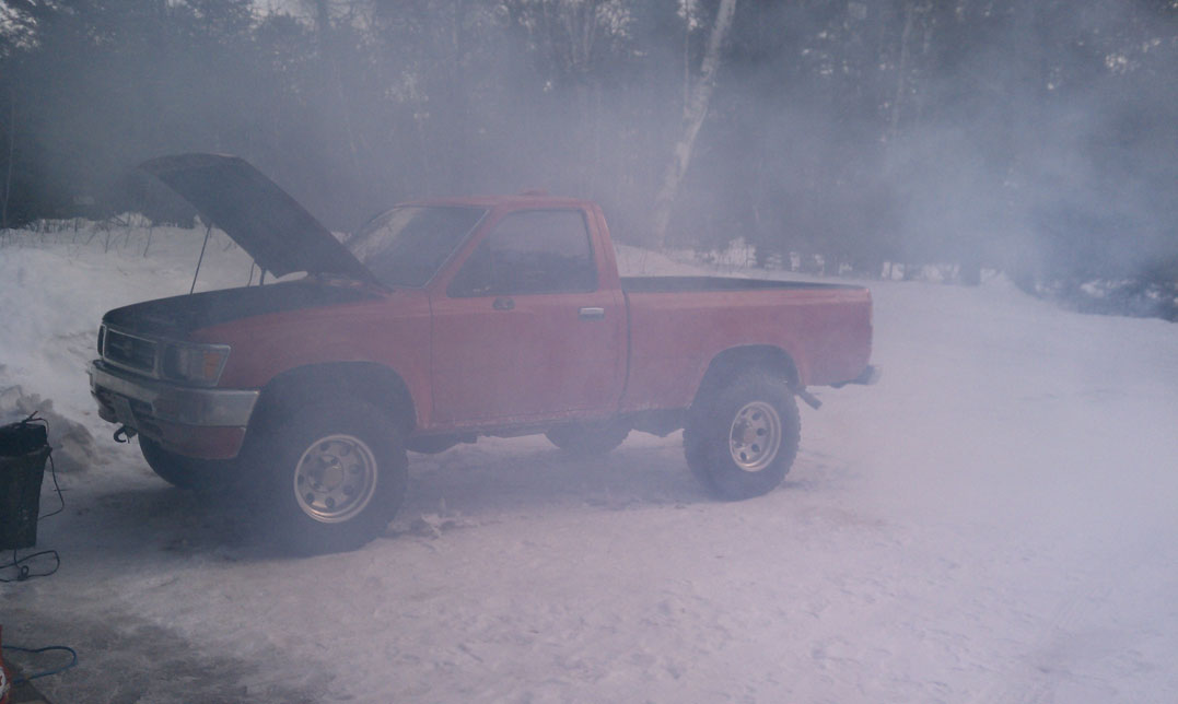

Update: I ran the starter as much as I could to get the oil out of the cylinders and I put on new plugs (the old ones were beyond their service life). Here is is after starting (note: it is not foggy outside, lol). I let it warm up to operating temp and shut it off. Other than the smoke, it appears to be running just fine.
Next: The rear diff looks like it leaked most or all of the gear oil. The transmission and transfer case look ok, but I will check them anyway. I couldn't tell about the front diff, but I will check that one too.
