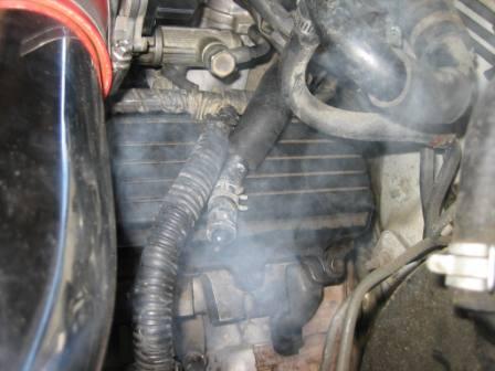

I'm about ready to give up on this thing. Everything I look at looks like it is in the correct position. I'm going to try taking more hoses off Monday after work to see if I screwed up an put some water hose into an intake line.
The guy I bought the motor from and the guy that guy bought the motor from said it was fine when they yanked the engine. That was about a month ago now. This is what leads me to think I still have something messed up.
But there is absolutely no way I could have screwed up the head gasket between now and then. Not even plausible.
Check out the the pictures. This fitting and this hose both create quite a bit of steam. Besides the obvious point that no they are not suppossed to do that what can explain the water comming out of them besides head gasket.

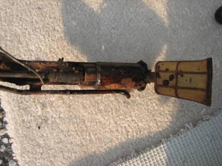

Ohh and a photo of the fuel pump just because.
