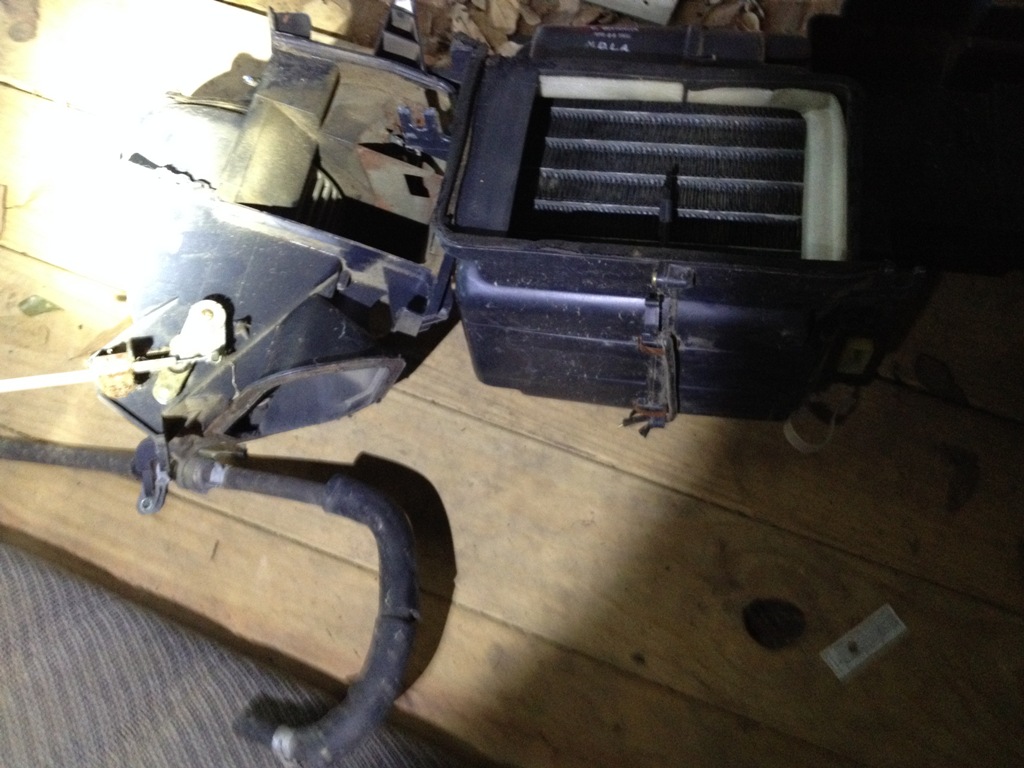

Well I found a spare blower box (one that does NOT have mouse poop all over it) in my "rented barn storage" spot.
It must have come from the 1987 parts 4Runner that me and someone from a news group (before we had these forums) way back when.
Here's the idea I came up with.
Even if I put a wire mesh screen between the blower box and the cowl - they mouse could STILL nest on top of the mesh, inside the "cubby".
It would be like a hamster cage - they poop would fall though the mesh - right into the blower box/.
So this is the new idea.
Make a layer of mesh to go between the blower box and the firewall.
Use a circle of mesh to extend up
Use ANOTHER flat panel of mesh with extra long edges. This can be "bent" to "seal over the cowl "cubby wall".
Even if they manage to squeeze in under (because the mesh isn't fastened to the "cubby wall", they wont get very far.
I suppose they COULD live in the area between the mesh and the cubby wall - but me thinks they will look for a better nesting spot...
I used 1/4 hole, galvanized welded mesh (aka Hardware Cloth)
box located on top of lower cowl hole
Found a spare blower box in my storage spot
box is fully wired crimped - not getting in w/o cutters
