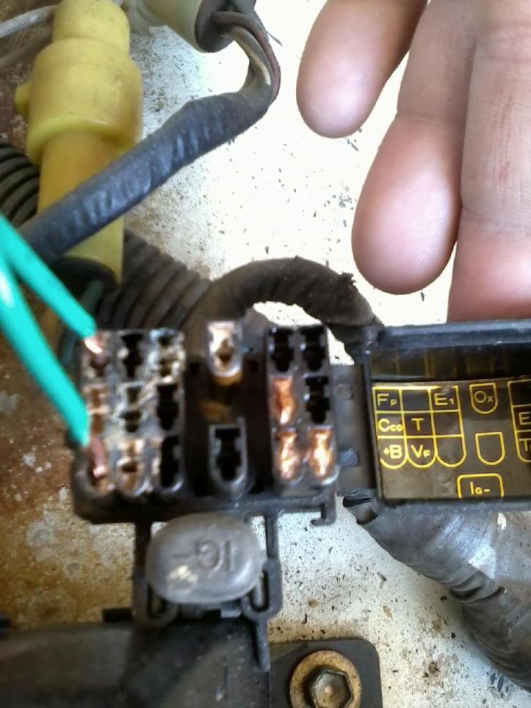

sb5walker says http://www.toyotanation.com/forum/80...g-igniter.html that the 22re has a VAST system rather than ESA. He believes the igniter can generate spark signals to the coil for a few seconds based solely on NE, even if IGT fails. But, without the IGF to the ECU, the ECU shuts down the injectors. (And, presumably, throws 14.) He concludes that the engine will run for a few seconds then quit, from lack of fuel. (Hence running with starting fluid.)
You could have a partially bad igniter (it's still generating spark based solely on NE, though), but the first place I would look is for the IGF signal back to the ECU.
Yes, it's multimeter time.

Fp +B Fuel Pump Test for 87 and newer. Use a paper clip for better results.

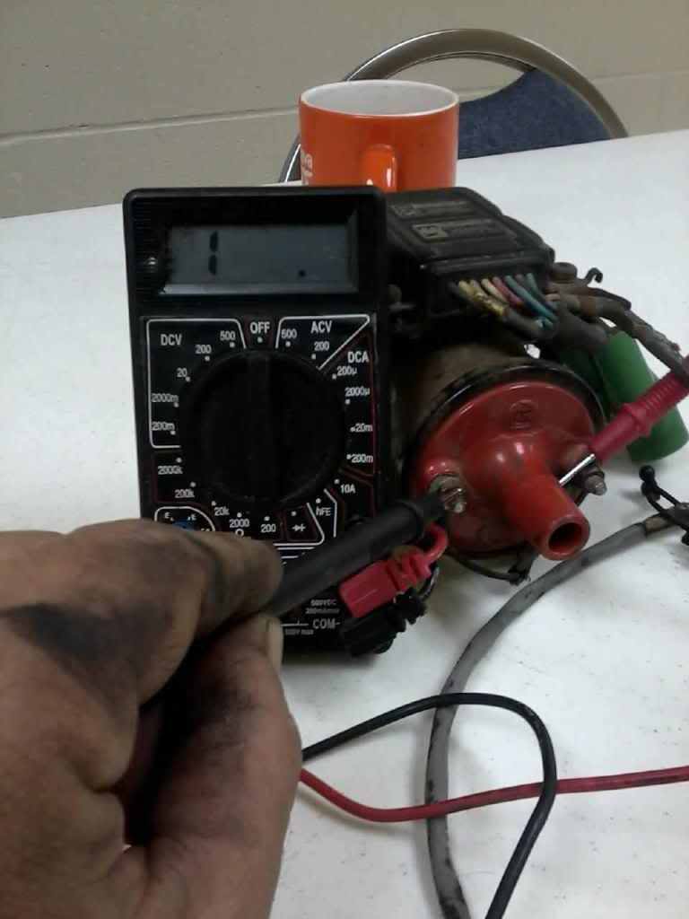

Past experience on a coil. Seems like the secondary passed.
I ran some test on my Igniter and the coil is showing bad on the primary terminals. I am getting 0 ohms and should have .4-.5 ohms. I am going to use the coil assembly off of my flat bed to see how things will go. I was getting a spark at the plug and the manual says if there is spark it should start. I have run into this in the past where I got spark and the motor wouldn't run. That was on a Ford. Hoping things go the same way on this one.

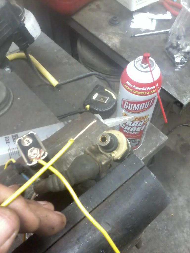

To test and clean my injectors, I take a 9 volt battery and by touching the leads a second at a time, it will operate the injector. With a rubber hose attached to a syringe and the syringe filled with cleaner. I put pressure on the syringe and touch the injector to the battery for a second. This will open the injector and let me know if it is functioning. It also cleans the injector.
You can also attach the rubber hose to the outlet side of the injector and back flush it. It takes a couple of extra hands to do the whole operation or I use a vise to hold some of the components to do it. You can use clips to hold the battery or injector connectors if you don't have a spare connector laying around.
There are some screens on the inlet side of the injectors that I have seen get clogged with rust and not let the injectors flow. There is a kit on ebay that sells the seals and screens for these injectors if you cant get the screens cleared out.

Yes. Same issue. Initial crank runs for 2 seconds. It is probably due to fuel from some injectors getting by. Then crank but no start. Starts with starting fluid. Plugs were wet. The corrosion on the harness prevents a perfect ground for the injectors. Redid the splices and easy fix.
I also did a similar set up as in above post to clean injectors. Found a syringe to fit over injector. I used a rubber hose to connect large part of syringe to injector. The red pipe off carb cleaner fits perfect in the needle end of syringe. When you spray the cleaner, it creates a pressure. Then use a battery to activate injector. Should spray out cleaner in the syringe. I wired battery to injector with homemade clips and put an inline push button switch to activate injector.

To eliminate the injection/fuel side, I would
Remove the crimps.
Use the LED to see if I was getting a pulse.
Do a resistance check on the injector.
Flush the injector to see if it is operating.
After that I would start to look at the firing side of the system.
Remove the crimps.
