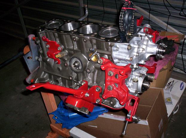

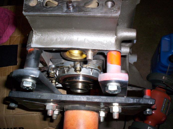

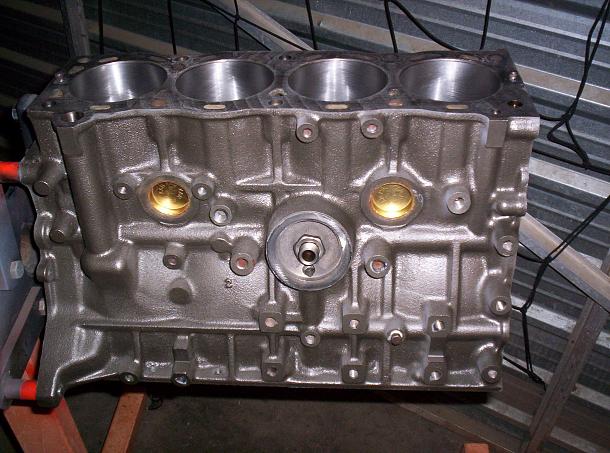

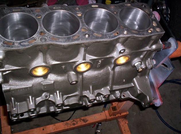

I painted it cast coat iron DE1651 from duplicolor. Installed freeze plugs, use permatex #1 if any of you are doing this yourself .
Attached Thumbnails 854x4's 22RE Rebuild Thread-picture-108.jpg   854x4's 22RE Rebuild Thread-picture-107.jpg   854x4's 22RE Rebuild Thread-picture-109.jpg

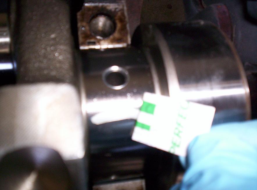

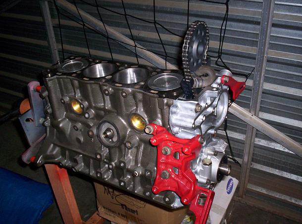

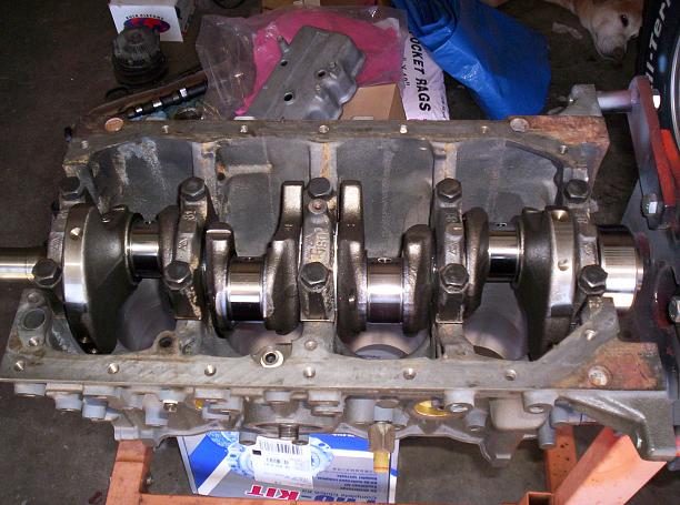

Got the crank,pistons,rear seal, timing cover, and oil pump installed.
Attached Thumbnails 854x4's 22RE Rebuild Thread-picture-110.jpg   854x4's 22RE Rebuild Thread-picture-111.jpg   854x4's 22RE Rebuild Thread-picture-113.jpg

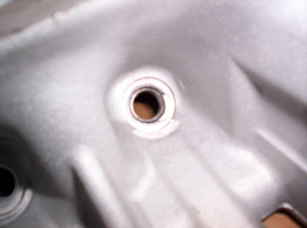

Timing cover pictures. Oil pans next.
Attached Thumbnails 854x4's 22RE Rebuild Thread-picture-112.jpg   854x4's 22RE Rebuild Thread-picture-114.jpg

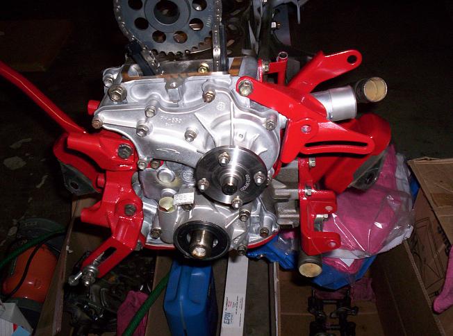

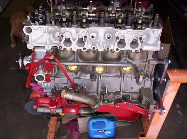

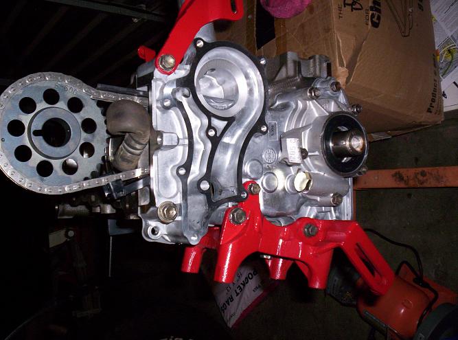

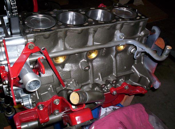

More pictures. I got the oil pan,waterpump, and some brackets put on. Took the head down to the machine shop and I should get it back next week. The plan was to get a engnbldr head but my old head looks in good enough shape.
Attached Thumbnails 854x4's 22RE Rebuild Thread-picture-122.jpg   854x4's 22RE Rebuild Thread-picture-123.jpg   854x4's 22RE Rebuild Thread-picture-124.jpg

pretty clean motor, do bad it's going into a vehicle that you have to use off-road

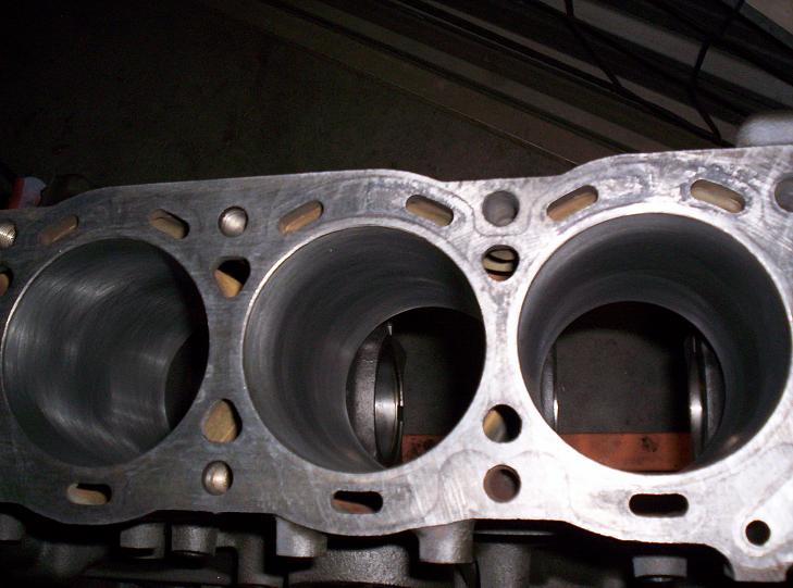

Got the head back form the machine shop. Hot tanked , valve job, surfaced, and number three spark plug helicoiled all for $170
Attached Thumbnails 854x4's 22RE Rebuild Thread-picture-128.jpg   854x4's 22RE Rebuild Thread-picture-129.jpg

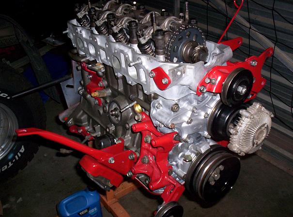

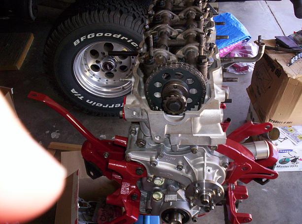

Heres the head on the block with 268 cam installed.
Attached Thumbnails 854x4's 22RE Rebuild Thread-picture-130.jpg   854x4's 22RE Rebuild Thread-picture-131.jpg   854x4's 22RE Rebuild Thread-picture-132.jpg

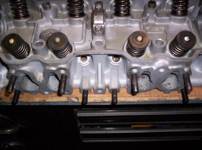

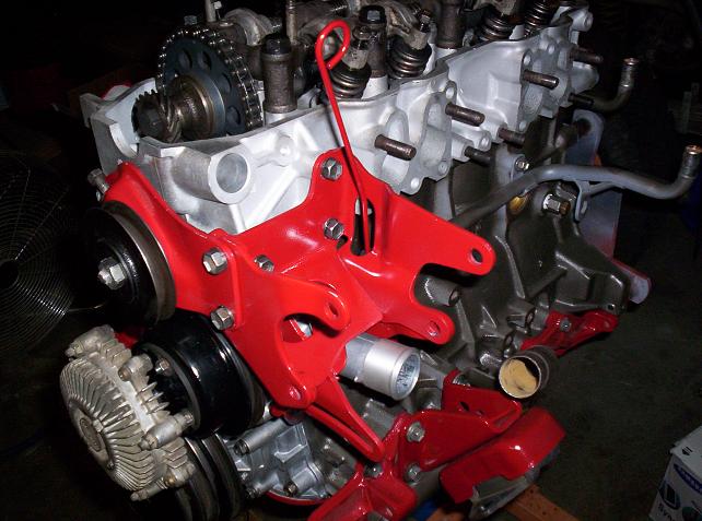

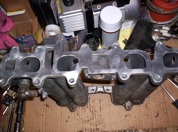

Heres some more pictures with some brackets and misc installed. Just need to adjust valve lash. The last picture is the lower intake after I took the gasket off using a bench grinder with a brass wire wheel. Yes its still flat I checked it with a straight edge.
Attached Thumbnails 854x4's 22RE Rebuild Thread-picture-133.jpg   854x4's 22RE Rebuild Thread-picture-134.jpg   854x4's 22RE Rebuild Thread-picture-135.jpg

I got my bottom intake cleaned and painted today, I even buffed the inside of the runners, now it looks like new on the inside no carbon or oil. I will post pictures tonight.
