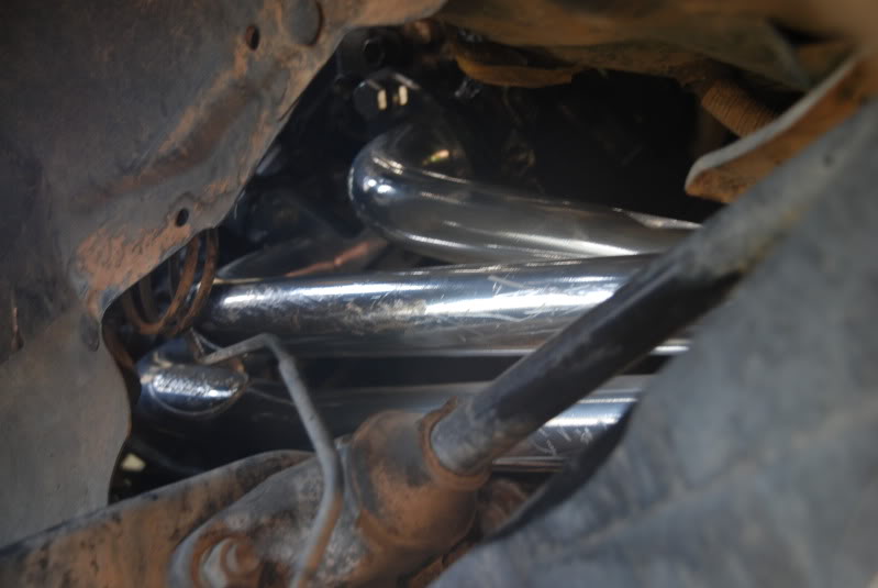

I like the idea of it, but that pipe going under the front drive shaft is just a waste of good money. That thing is gonna get trashed like that. Real nice system, poor routing. I left the stock manifolds on and the pipe to the cat. Put on a high flow flow master that comes out into duals. 200 bucks, and sounds awesome! Everything is nice and tucked up under the truck. If possible you might want to check into rerouting that pipe.

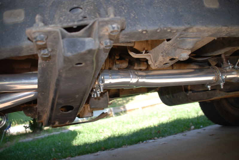

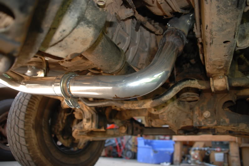

The down pipe does not look right to me. I am sure its suppose to be that way, BUT, I think it is gonna get smashed. Unless you do no off roading at all. Down below the driveshaft is where the tuff stuff is, and thats a hollow pipe. Just my opinion?

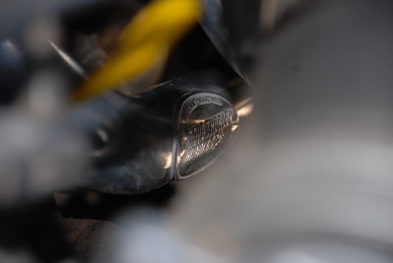

Driver Side
Doug Thorley Emblem
Another Shot of the Driver side
Crossover
Downpipe

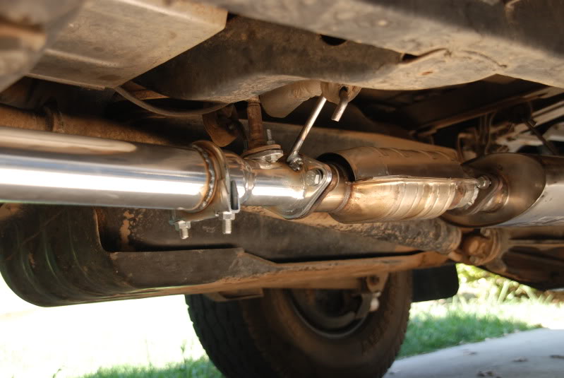

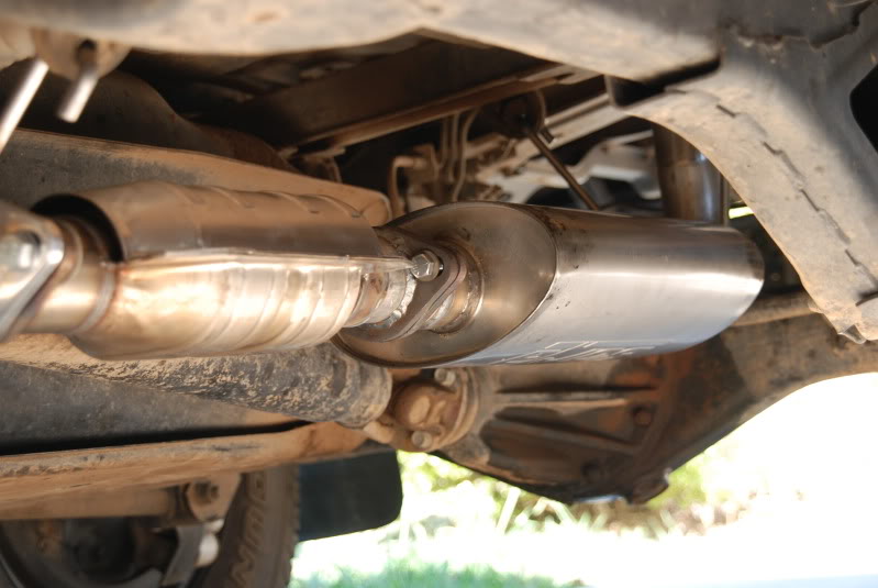

Cat + downpipe set up
Muffler + cat set up

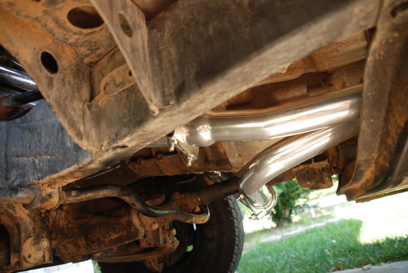

A shot of the passenger side headers going down to the crossover
passenger side piping for crossover

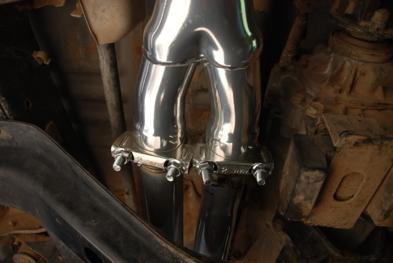

Dual inlet for the downpipe

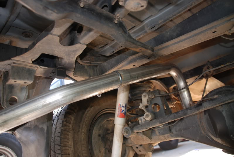

Shot of the tail pipe

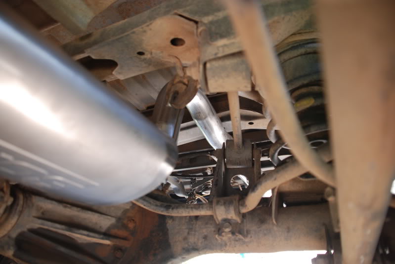

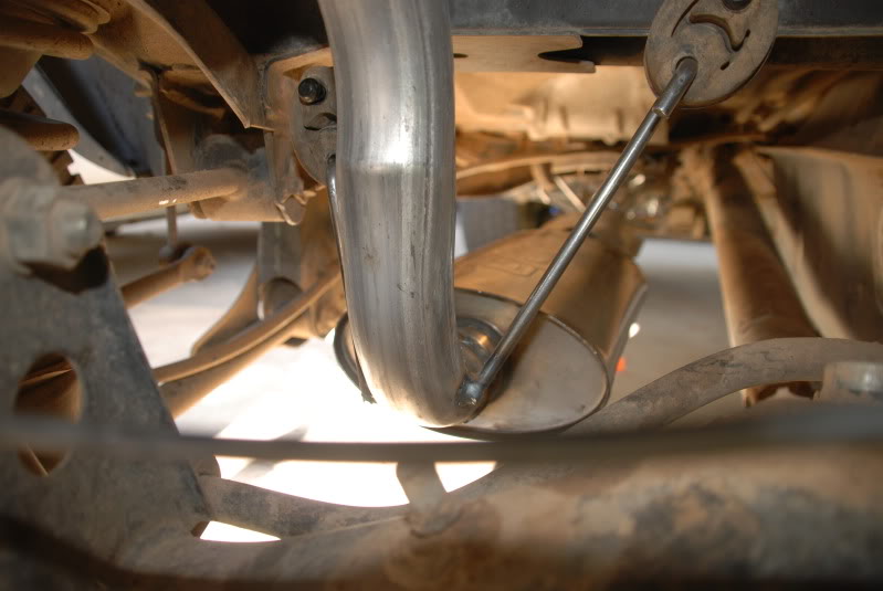

Wanted a shot of the bend at the muffler for the tail pipe to clear the axle.
Another angle for the tail pipe

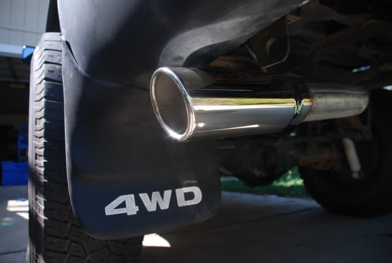

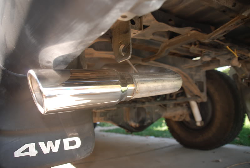

2.25 - 3" tip
Another shot of the tip

I've been on a few wheeling trips since installing the exhaust, and i personally have had no issues with it. All headers for the 3.0 are designed this way. ( LC engineering, Doug Thorley, NWOR ) I can see how you'd say it could be smashed but i would serious have to be the most unlucky person in the world... it would hit my crossmember before it would hit the exhaust piping. the pictures dont really do it justice, but the piping is actually in reality about an 1 1/2" above the crossmember. I did this exhaust upgrade and went to kyburz with no lift on 31s... never hung it up or hit it on anything. now im on 33s and will be lifting it. If it ever concerns me, i'll just get a belly pan
