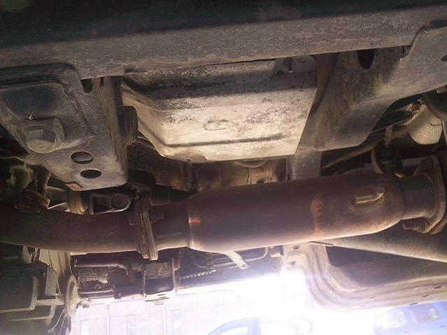

Update:
Finishing my exhaust completely at 8:30 today. I found out that the rattling noise is the fact that I have absolutely no backpressure. Im putting my stock catalytic converter back on to have some restriction. So no more straight pipe. I'll do a video of how it sounds with the catalytic converter back on. It was fun while it lasted, but I cant hear people in my back seat if im anywhere past 3k RPMS... ( 65 mph is 3k rpms ) so I just get a huge roar. I expect it to still be load with just the stock cat on, so hopefully we'll have no disappointments haha
#266
I cant risk driving around without a catalytic converter. California just raised all the fines here. I had fun while it lasted, its not a big deal. I still have the horsepower gains, more backpressure, and a much quieter ride.

Nah, i'm leaving it how it is for now. I had no backpressure, so its nice to actually have some now. It will not be quiet for the rest of its days... it'll have a smog legal and stamped high flow cat eventually!

I feel like i've lost all love for my 4runner now that I changed the exhaust. I loved the uniqueness it had with the exhaust and Im going to be changing it back to 100% innerchangeable with the stock catalytic converter. I'll smog it with the cat on, then pull it off and keep it stored in the truck. but I cant stand the quietness im dealing with now. I'll post videos of how it sounds in the truck and what not for those who want to know, but I hate it...

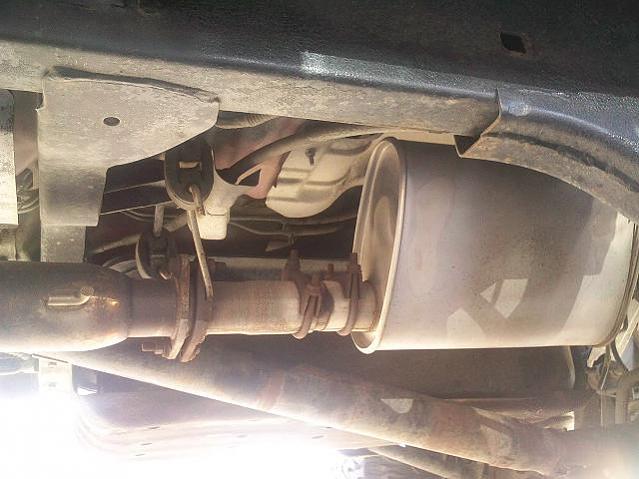

Emissions or not, your $H!+ sounds very good. My setup sounds (compared to your audio) a bit quieter but deeper tone that maintains true and rich from the start-up to throttle with a slightly different setup. I eliminated the cat and have a glass pack/presilencer bullet which goes from 3", expands to 4", and back to 3" before flowing to a dynomax super turbo muffler. Here is what it looks like:
