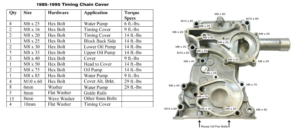

Don't know if all of you are signed up to receive the LCE newsletter, but in the latest they had a pretty cool chart for the 22re timing cover bolts sizes and where they go. Something handy to have around.
The link to the larger image is here http://www.lcengineering.com/LCNewsl...are-Kit_lg.jpg
When I first looked at the chart I noticed a couple of minor typos and let them know. Just to say thanks for looking out, they sent me a $10 GC and this autographed catalog and couple of stickers! Pretty cool of them eh?! I think the whole staff signed the cover. Bad thing is I see things I want that I wouldn't have seen on the web nothing beats a full color "hold in your hands" catalog....kinda like the Sears Wishbook when I was a kid

EXCELLENT!..thanks for posting this.
and the wishbook thing....ahhh yes.
EDIT: printed a copy for myself. going to put it in the FSM.

Very nice.
Can't believe how many times this question gets brought up...

yea if a person hasnt done alot of removal and insatall on the front cover its easy to hit the wrong hole...dont forget the one or two in the front of the head either.

well i had AC and some of the bolts were different than what most diagrams were saying.

Are these bolts coarse or fine thread? I put in an order for them from Fastenal (all coarse) the smaller ones matched up with the old ones but the larger ones (M10x60) didn't match up with old or fit in the threads? Are they different or are my old bolts and block holes stretched and corroaded. So just fine for all/ just coarse/ or some of each? Thanks.

I can't remember...I think it's called the "pitch" and my guess would be they are either 1.25 or 1.50 or a mixture of both. Somebody should know.
