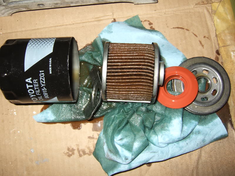

I cut the oil filter open that I used for the 10 minute initial run and 5 mile drive. This is the first time I've opened one up. I'll look at it closer tomorrow in the daylight. A magnet run through the drained oil didn't pick up anything except a few tiny flecks. They could have come from the tranny oil the pan held before.

Awsome job brass. You are a "pro" now. When I rebuilt my 22RE, I spent like 6 months with my eyes on the temp and oil guages. Now, it's just nice to enjoy the drive without worry. Congrats! I'm happy for 'ya.

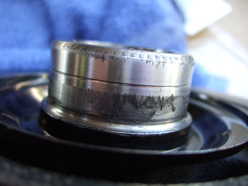

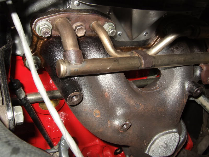

I retorqued the exhaust manifold nuts as Ted had advised. They all required some turning. I'm using 30 ft/lbs. The book calls for 33, but I feel better reducing it slightly since I used anti-seize on the threads.
As I predicted, the Crisco seasoning has already burned off. See around the edges how you'd have a nice black color if the temp didn't get quite so high. Oh well, it was worth a try. Kind of interesting to see which parts get the hottest. The seasoning on the flanged area that bolts to the head hasn't even darkened yet.
Before, I used wood blocks and an old woodworker's clamp/vise to press in the oil seal. The thinner Toyota seal has a double lip, which I learned from ruining a nice Toyota rear seal shouldn't be done that way. Looks like a slice of 2" schedule 40 PVC pipe will be close to the right size to press or tap it in. I'll find out in the morning.

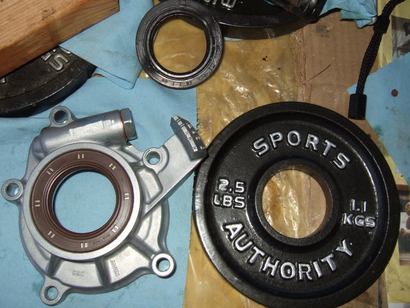

Removing the oil pump didnt spill much oil. Hold some paper towels on the bottom as it comes off. After sitting overnight, I'm guessing maybe a 1/4 cup came out.
A weight plate came to the rescue for seating the new seal. The inner raised area is about seal size, and the plate diameter is just small enough to clear the timing mark extension.
This is a hair deeper than I wanted to seat the new, thinner Toyota seal, but after one part went that deep I had to make the rest match.
To get an idea where the new seal rides, I put the oil pump housing in place loosely with a couple bolts, greased the crank pulley and put it on. Slid it back and forth a few times. Looks like the new lip is well away from the groove.
