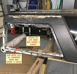

While you have the body open, may I ask for dimensions of the lip where window is mounted and how deep it is recessed from main body? Would help with design/ concept of gull-wing window.

pretty equal at 9/16 all the way around. Also attached pics of 2nd coat on top
