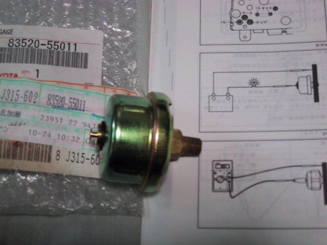

rockauto sells the sender.
None of RockAuto's senders have pigtails.
Any chance you have an aftermarket setup? For instance, is there a splice in the harness on the gauge-side of the pigtail connector?

That's the problem I'm running into. Not sure how to wire it in. I went to the toyota dealer and got a part number and looked it up and it looks like the rock auto version. The counter guy insisted it would have the pigtail on it. I googled the part number and it's similar to rock auto part maybe a maybe from toyota?

Picture of toyota actual part.

Called toyota and they have no answer as to why there part has no harness or have a reference for a connector
