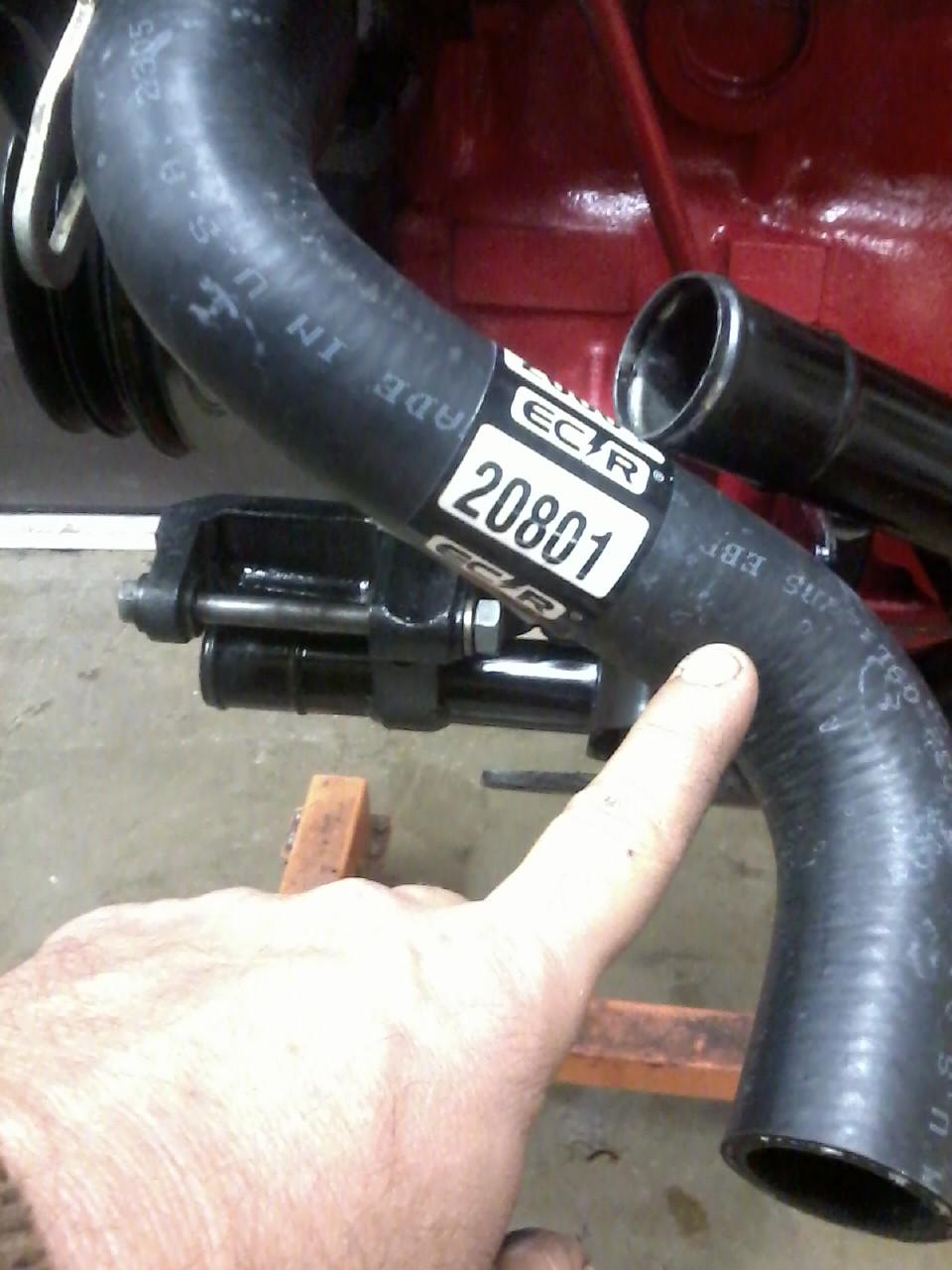

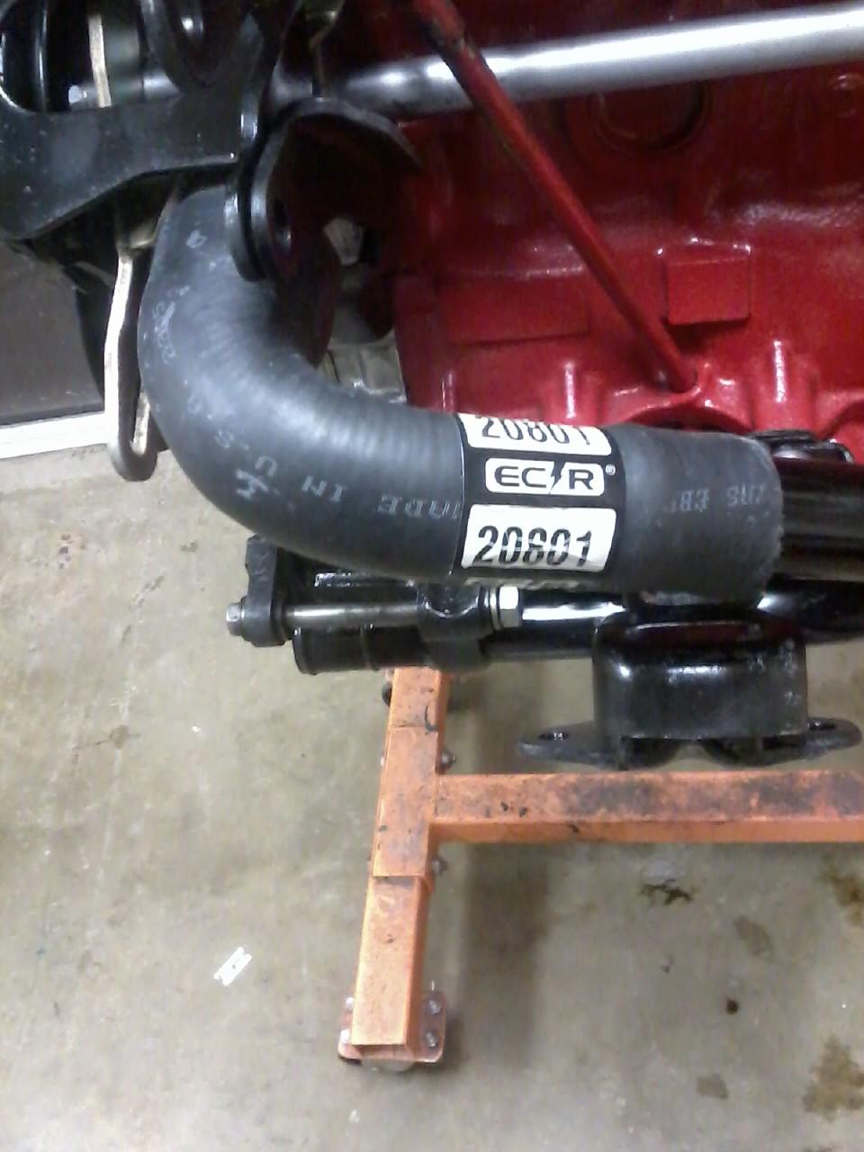

Here is a picture of about how much room mine has. It is not completely put together on second picture but should give you an idea. Also you can save a few bucks by using a parts store hose Gate# 20801. I also wrap my hose clamp with electrical tape since it is so close to the alternator when replacing that hose.
Gates PN#20801, just cut off where my finger is at. A lot cheaper then the dealer.
Here it is cut to length and on. I need to get some new hose clamps to finish the job.
