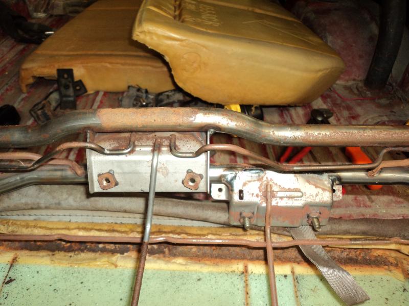

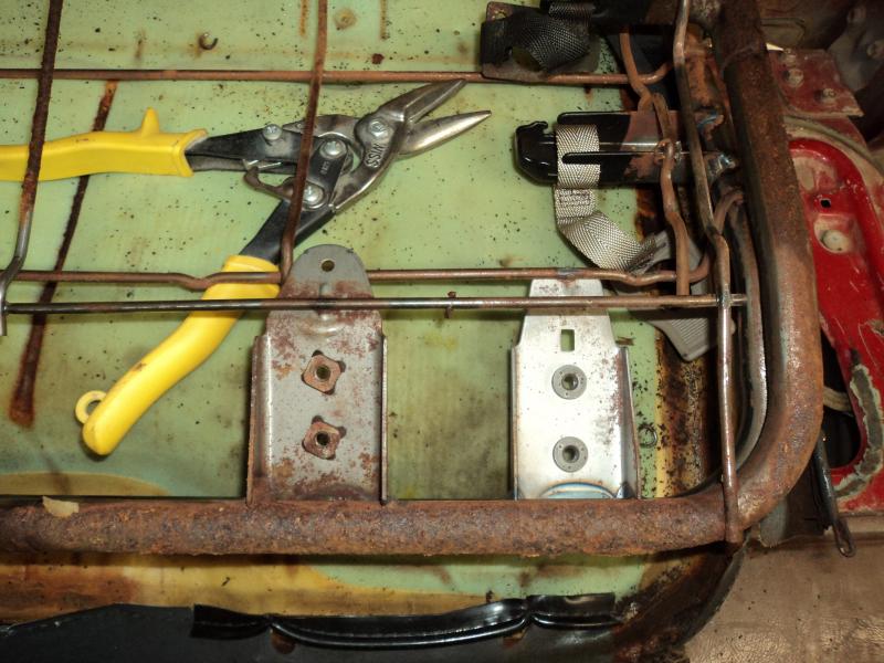

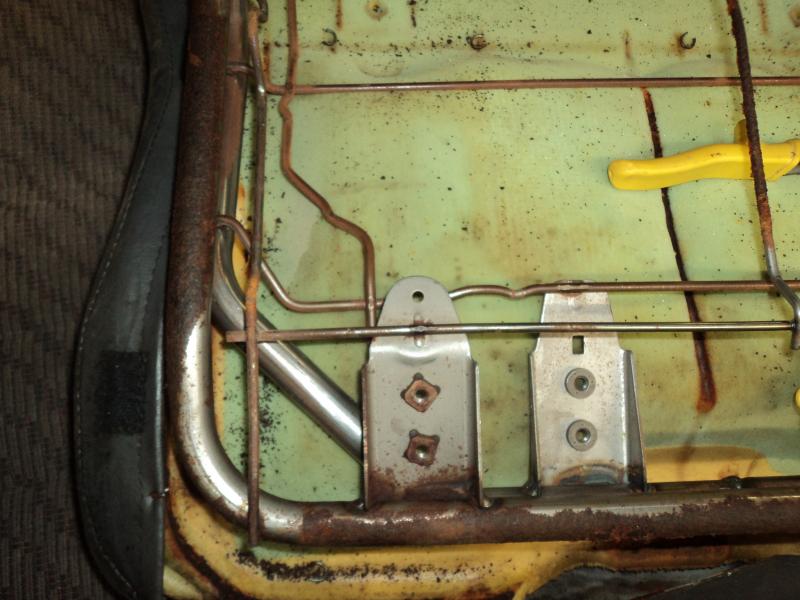

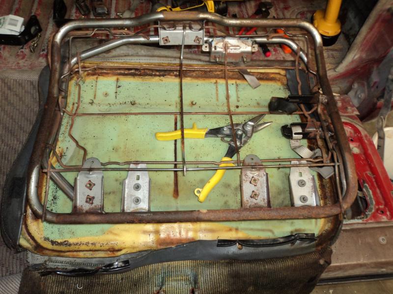

The rears, unlike previously stated, are NOT as simple as swapping the frames around. For the backs, that works. For the bottoms, there are SIGNIFICANT differences that require some fabrication if you want things to be right. Now, if you don't care about your seat bottoms latching and want to drill holes in your floor pan, then sure, they'll bolt right in.
But nowhere close to fitting using existing holes, even with swapping frames. Can't just swap covers either, as the frames are shaped differently. Here's some pictures....
The original 85 frame is on top, 94 frame on the bottom... Notice how far off the brackets for the legs are.
See the corner difference? Closer shot of the brackets as well....
Latch plate location. And notice there's a difference in shape between the frames as well....
Other corner.... Way off
Now I'm posting this because I searched the CRAP out of this topic before I pulled the trigger on this swap, thinking that if all I had to do was the seat backs, hey, too easy. And that part is very easy by the way. BUT those SAME threads said the bottoms weren't a problem either, and yet here I am. I'm going to cut and weld and make the old frame fit the foam like I should, but I know not all of you can pull that off, so I'm putting it out there for the rest of you so you know. Pictures don't lie!
