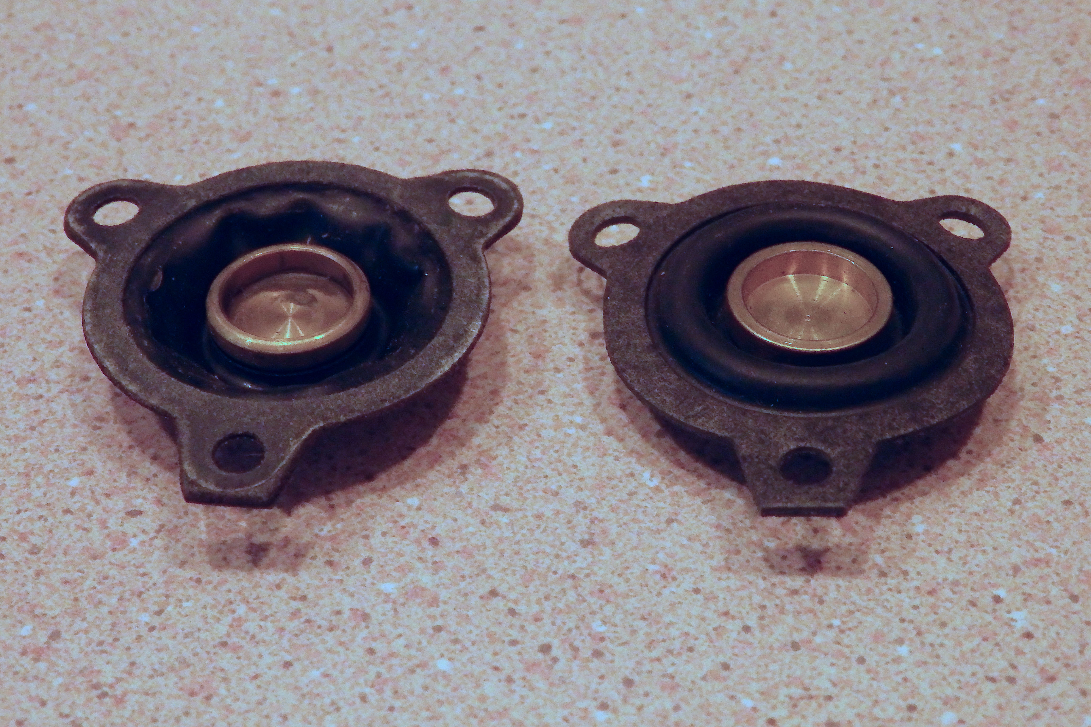

First, thanks to jimbyjimb for his ideas and suggestions. While I agree the emissions system is a lot of tinkering to make something run better, I'd rather not start removing whole pieces, at least not yet. After replacing the muffler (it needed it) and being told the catalytic converter was OK (an honest muffler tech if there ever was one!), I bit the bullet and went to Toyota dealership for a diagnosis. While it was stuttering and puffing when I pulled in, of course it ran fine when the technicians looked at it and drove it. Determined to find something, I was told I needed a new clutch! Dismayed, I got the technician to take another test drive, and I got to ride along. The patient ran fine ... whole going the doctor thing. BUT, in talking directly to the tech during the drive, I was able to pass on more of the symptoms than the service writer had included, and he thought it sounded like the Auxiliary Acceleration Pump (AAP) Diaphragm. When we concluded the test drive, he even took off the air cleaner to show me where it was and a way to troubleshoot it on my next cold start. The diaphragm was cracked, allowing fuel to enter the vacuum system and pumping way too much fuel into the carb. Between a lot of idling and revving while trying to diagnosis it myself and the trip to the muffler shop and the dealership, I used up 6.8 gallons of gas and only traveled 66 miles! As it turns out, once warmed up, the symptoms continued even though the BSVS was not calling more fuel, and it was stuck in this overly rich cycle. Once the engine was cut off and then restarted, and if it was still warm, it cleared the excess fuel and/or fuel in the vacuum system (usually by a hard start) and then it ran fine. So, my intermittent problem was really still there, it just only presented itself on a cold start. Three hard to reach screws, and investment in a ratcheting right angle screwdriver, a call and trip to NAPA Auto Parts for a new $15.95 AAP Diaphragm, and all is right with the world.

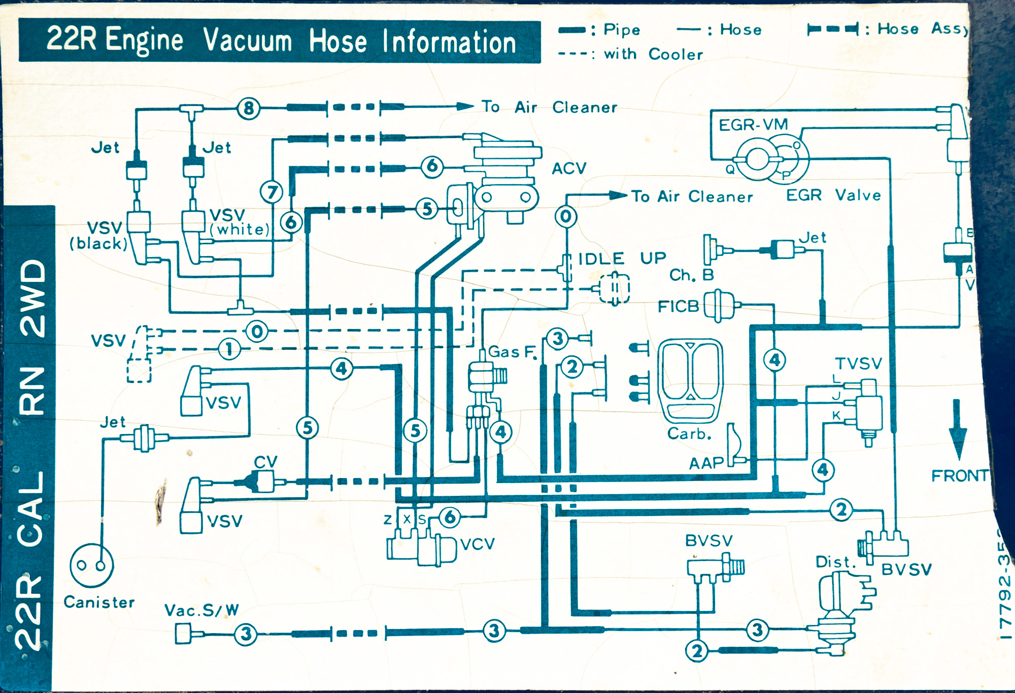

I went through the book and checked a bunch of stuff to no avail. What finally nailed it for me was letting it idle cold and rough as it was, and pinching off vacuum lines at the source on the manifold until I found one that smoothed idle out.
When I pulled that line off at the source I found gas in it. I traced the line back through to the "TVSV", and then to the Aux. Accelerator Pump diaphragm, which was leaking gas into the vacuum system, especially while cold and the TVSV was open and allowing a path to the intake.
My immediate fix was to cap off the hose fittings between the AAP and TVSV, and this alone restored the ability to start the engine and drive when cold without any major headaches. I've since replaced the diaphragm and all is well.
