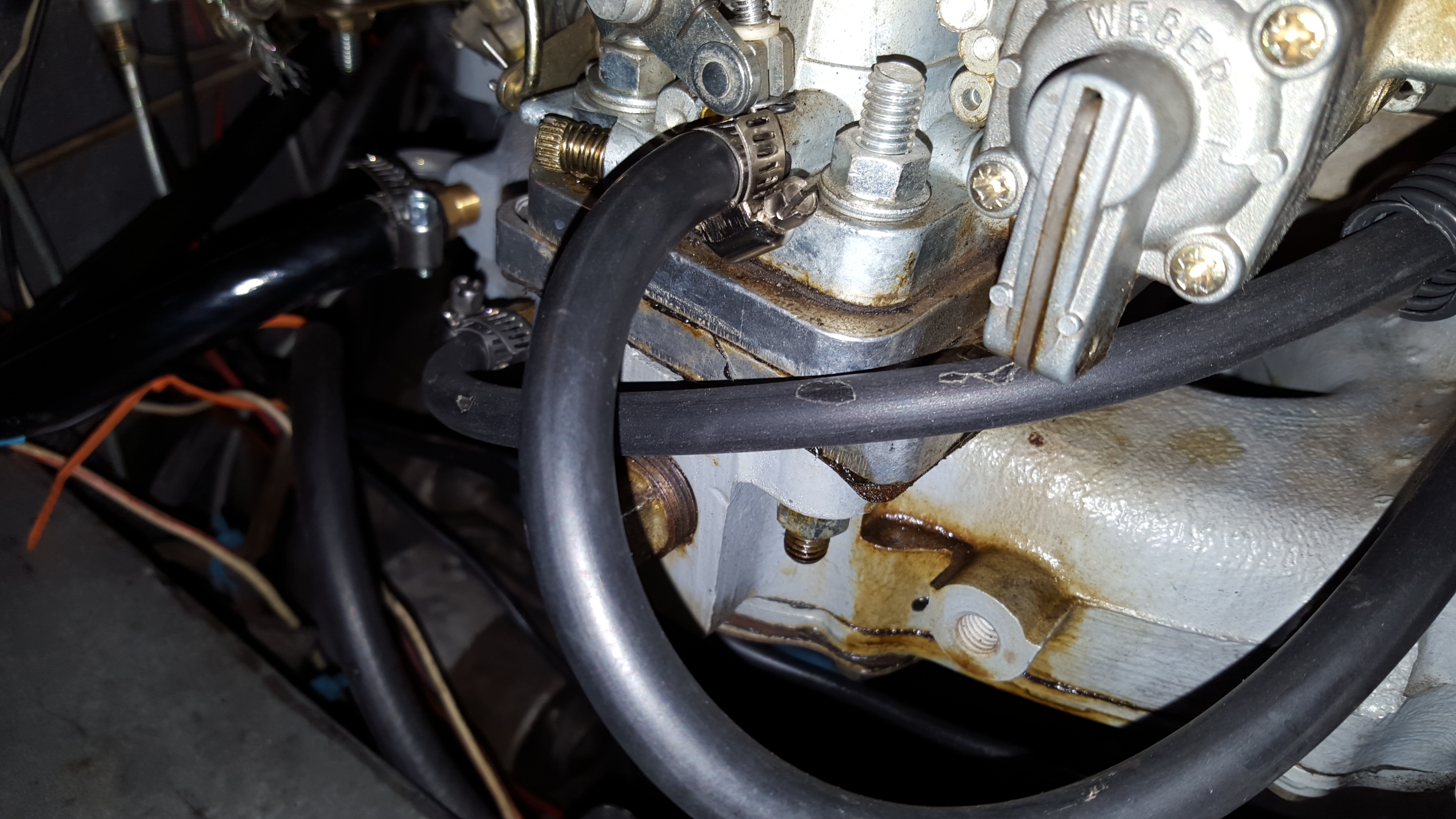

It's a 1982 22r, runs very good for the most part but I"m having a hard time getting rid of the delay/stumble when I floor it. There is an approx 1 second delay and then it takes off like a bat out of hell. It happens pretty much no matter what RPM I'm at.
i'm NOT using a fuel pressure regulator but do plan to order either the Weber one from LCE or the less expensive Holley one from Summit. I tried connecting a fuel pressure gauge but the needle just bounces rapidly between 2.5 and 6 lbs. I called HOlley and checked forums and that seems to be a well known problem solved only by using a regulator or getting an oil filled gauge.

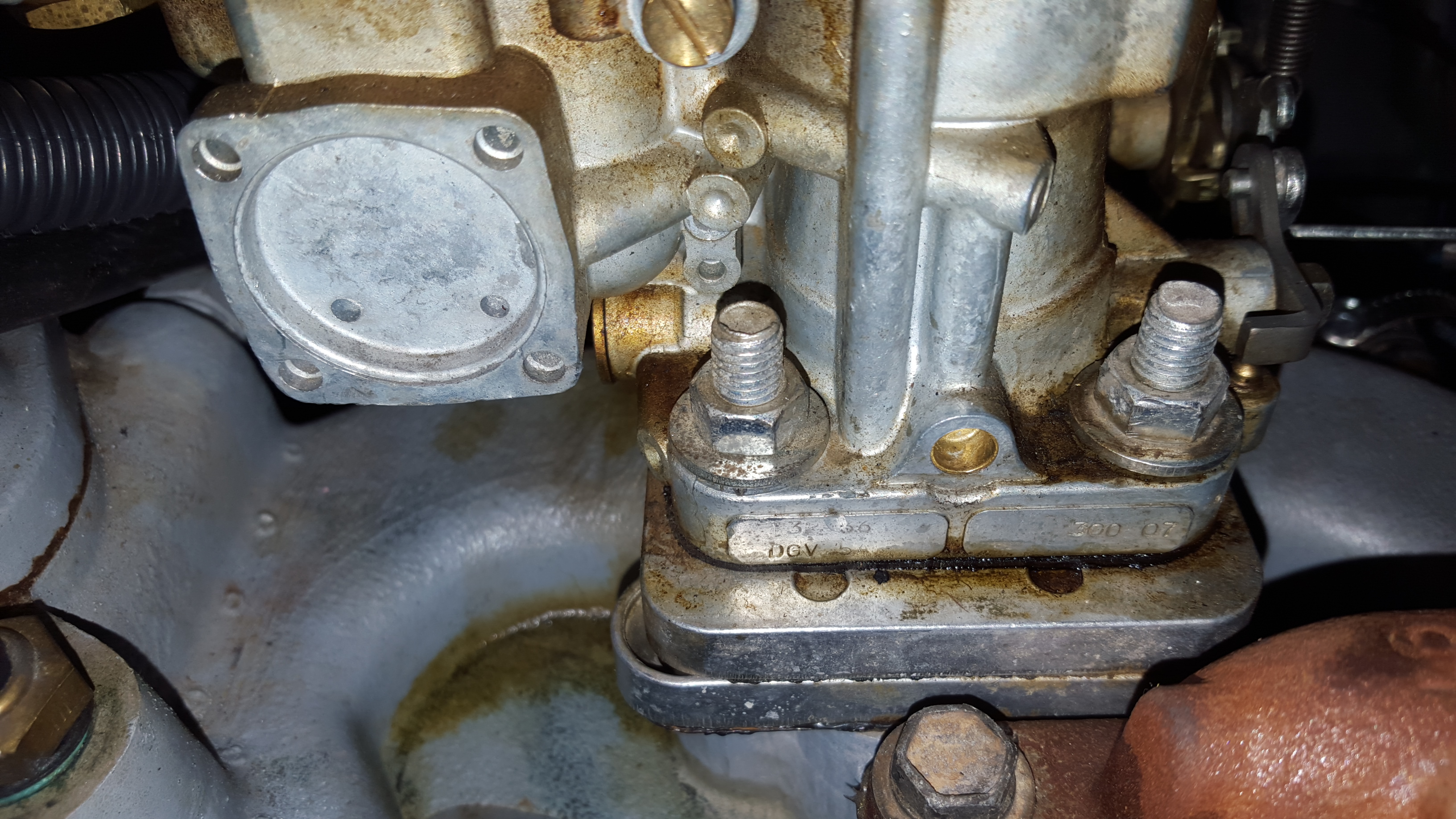

I have noticed what appears to be some leaks though, SEE PICS. When I spray carb cleaner around the base, there is no change in RPM so it must not be leaking much. ANY SUGGESTIONS BASED ON THE DARKER FLUID RESIDUE WHICH YOU CAN CLEARLY SEE IN THE PICS?

Without a fuel pressure regulator, you are basically negating the purpose and function of the floats within the carb. Instead of the float closing the needle to limit the fuel level in the bowl, the extra pressure is simply pushing fuel past the needle and flooding the bowl. The delay/stumble when you punch the gas is a result of inducing a rich mixture that can't properly burn. Get a FPR and your problems will likely be solved

That yellow staining is varnished fuel. The source is likely from a leaking gasket between the carb and the intake manifold. The part that you are calling the "lower intake manifold" is actually the intake flange/water plate. It houses the cold mixture heater (CMH) which is directly exposed to the air/fuel mixture within the intake. It also routes water through the coolant passages in the intake. Unless you live in a ridiculously cold climate, I would recommend replacing the water plate with one of these:
http://www.lceperformance.com/Water-...-p/1032010.htm
http://www.lceperformance.com/Water-...-p/1032003.htm
You likely have the 11 bolt plate, but look under your intake to verify. Those water block plates from LCE just eliminates the CMH. The CMH is only needed to heat the air/fuel mixture during cold starts. With a Weber and moderate climates, the CMH isn't really needed. I don't have one on my truck and I haven't started it in over two week, but I guarantee that I could go out to my 30* garage right now and my truck would start up with no problem at all with a 2 second bump of the ignition.
As for that broken bolt, get a bolt extractor and remove it or drill it out and re-tap the hole. The reason why I suggest that you do that (as well as replacing the water plate) is because that stock plate is very thin so without all of the bolts installed you will open yourself up to vacuum, fuel and coolant leaks. You can even get coolant in your intake thus running it through your combustion chambers - not an ideal situation.
