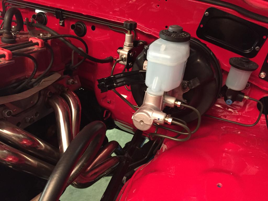

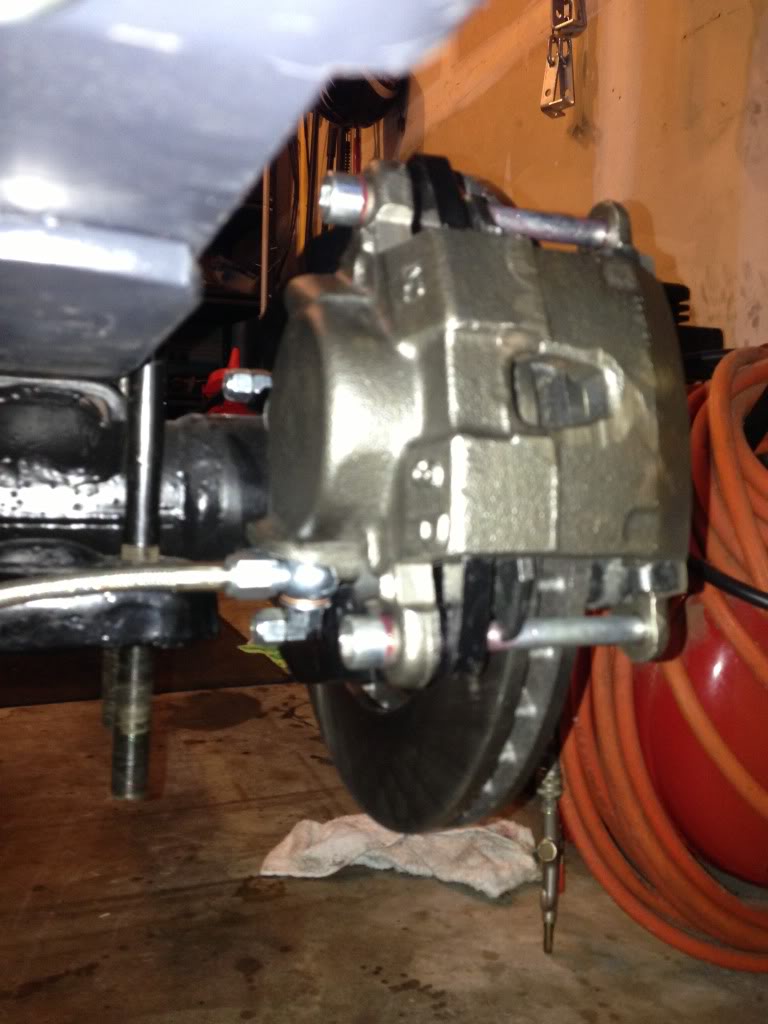

So here's the deal... I did a rear disc brake conversion on my 1983 Pickup. Here's the specs:
-Sky brackets
-Monte Carlo Calipers
-GM 1/2 ton rotors
-Braid stainless steel lines on the rear axle
-All new hard lines throughout
-Wilwood manual proportioning valve
-New 1" bores Aisin MC
-Stock brake booster
-Stock front brake setup with new rotors, calipers and pads
-Rolling on 15" alloy wheels wrapped in 31x10.5 tires
The brake lines of have been bleed, there are no leaks and th proportioning valve has been adjusted properly prevent rearend lock up.
Now here is my problem. My brake pedal has a really firm feel to it with about half of the travel that I feel that it should have. The brakes are also VERY touchy - if I go from driving my Tundra to my Pickup I damn near give my passenger whiplash when I first hit the brakes! The pedal also seems to not want to pump up like it should. The brakea definitely stop, but I feel like something isn't right. Any suggestions out there? Do any of you suppose that I need to upgrade to a dual diaphram booster? Do I need a residual valve even though I have a 1" MC and a proportioning valve?? Any help is appreciated - thanks guys!

Oh, and I forgot to mention. I read somewhwre that the shaft in the stock booster is too short to fully compress the piston on the 1" bore MC. Is this true??

Bingle, Thanks for the input so far. I have the 92-95 4Runner/Pickup master cylinder Aisin Part #BMT-081 or Toyota Part #47201-34010. I'm fairly certain that it does not have a built in residual valve and I too was thinking that upgrading to a dual diaphram booster would only magnify my issue.
It's not that I'm not getting good brakes - they are definitely there. It's just that I don't have much travel in my pedal so it is really touchy and I have to be sure to apply gentle pressure when I'm braking which isn't a big deal, but my concern is if I have to quickly slam on the brakes that I may lock up and lose control of the truck. It seems the volume within my brake system is just significantly lower than the that my 1" MC puts out. Also keep in mind that I have new brake pads all the way around so that also takes volume out of the system.
Now tell me this, I assume that the front V6 calipers have more volume? How difficult is that upgrade? Actually, I don't care about difficulty, I care about what parts are involved. Do the rotors and calipers just bolt on or do I have to completely swap hubs? I rebuilt my front axle with this resto so I'm not exactly eager to throw that work away.

V6 upgrade up front is a bolt on affair. I believe the taco front brake upgrade is more involved but it gets you to a width that matches the v6 rear, or that's what I've read, but that doesn't aply to the problem at hand. I had to trim the dust shield a little and I had to grind down the cooling fins (not a ton, maybe 1/8") on the outside of the V6 calipers to clear my wheels, but otherwise it was exactly the same as changing out normal disks and calipers. The SFA calipers have one large and one small piston and the V6 have two large pistons, so I would assume it takes a little more volume to move the V6's. I got some nice LCE vented/slotted rotors, I know you hate dealing with those guys, but that's what I went with.

I adjusted the proportioning valve enough to keep rear from locking up but I haven't really played with it much. I probably should because I noticed a little more brake steering earlier this week when I was braking hard so I may need a little more pressure to the rear end to keep it from rearing up as bad under hard braking. I removed the stock torque rod so obviously it is a little more apt to brake steer with the stock push/pull steering. It's really not bad once you get used to it.
I really think that my problem is volume which I don't think that I can solve without any changes to the calipers. I also haven't driven the truck in a couple years so I don't really remember what the brakes used to feel like in order to compare. I do know that you don't want to be in my truck after I drive my Tundra if you have neck or back issues.... My Tundra brakes are really soft so the first couple of stop signs in my 83 can be a little hazardous until I become more conscious of what I am driving. Who knows, this may just simply be the difference between and modern and classic brake system. Anybody want to slide by and take it for a test drive to see what you think? LOL
