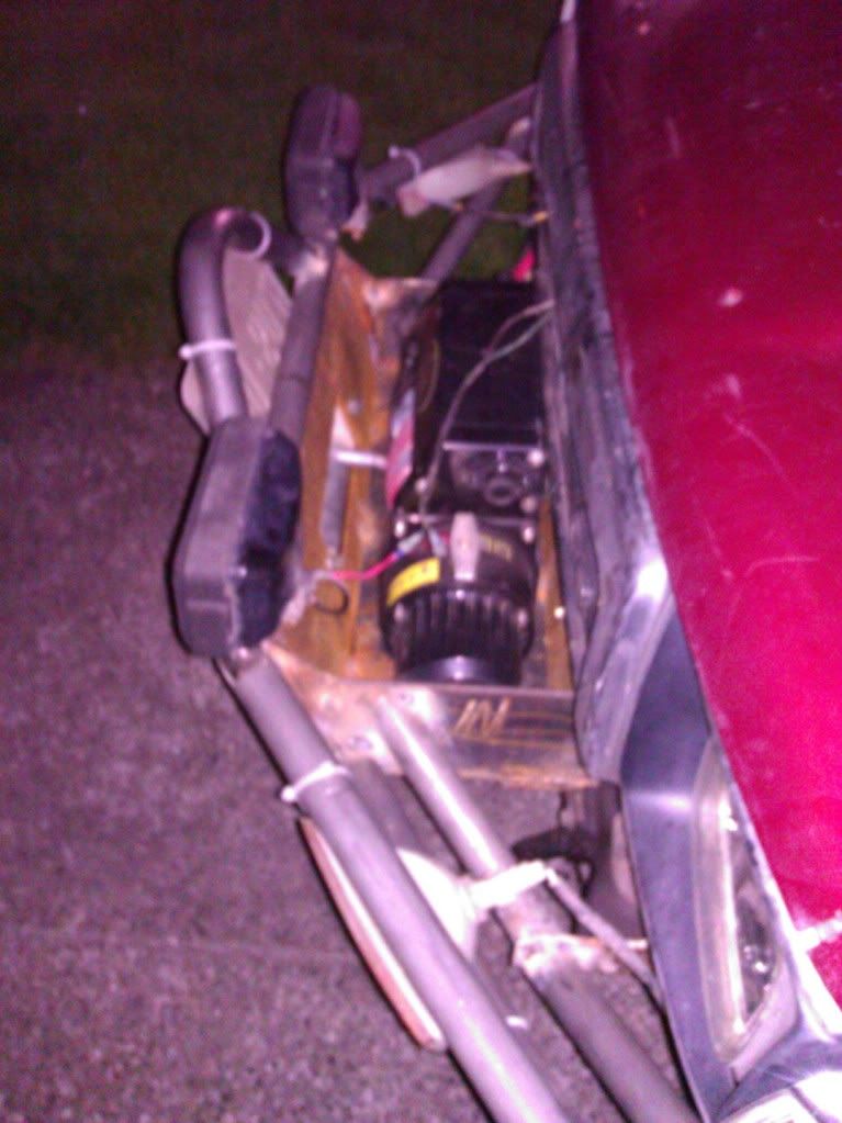

just added a brace but just tacked it in place,

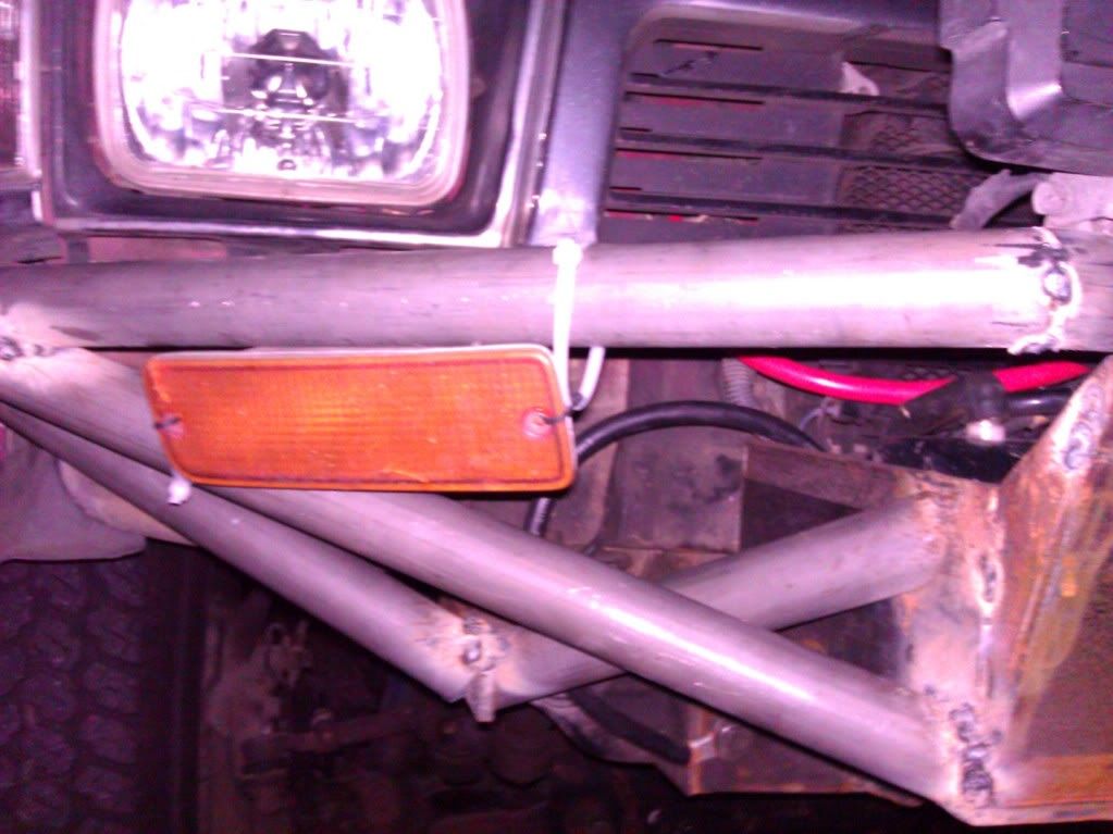

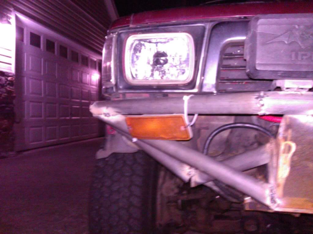

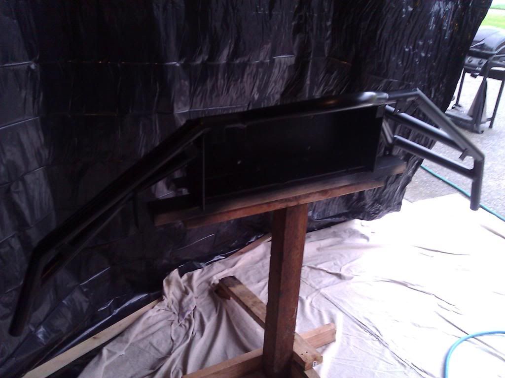

added the front plate, just tacked into place. \
Old 05-20-2011, 09:25 PM
Moonfish's Avatar
Join Date: Jul 2008
Posts: 266
Received 1 Like on 1 Post
If you bevel the edges so a weld can fill it in and lay flat it will look better and be stronger. If you just tack it together, it would be easy to drop it off at a welding shop and have them finish the welds. It wouldn't take long that way so it would not be a lot of $$.

im having a buddy who builds bumpers weld it all up tomorrow and bend all my tubes.

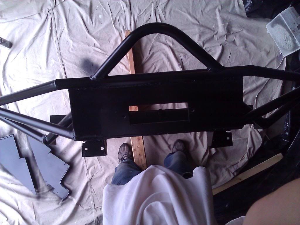

so now i have it all tacked up and ready got the welder to weld it all up. maybe by next weekend.

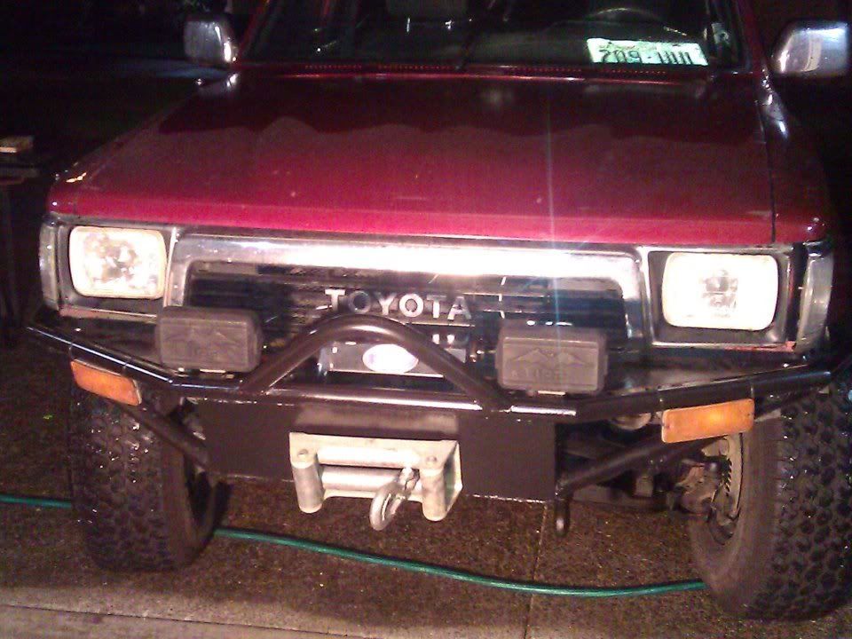

Old 10-08-2011, 08:18 PM
justin_4runner's Avatar
Join Date: Dec 2010
Location: tacoma wa
Posts: 1,295

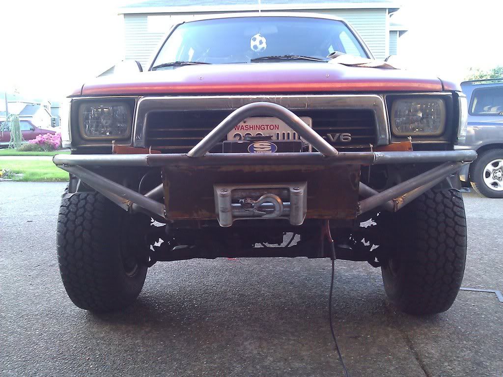

all done and installed.... i like the way it came out,
